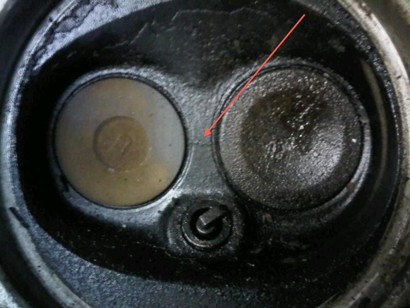

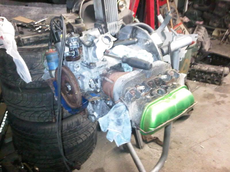

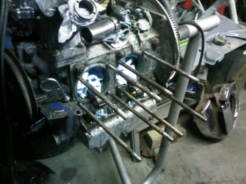

So I tore into the engine today , i swore i wouldn't do this . Took apart the 1-2 side
Any thoughts on a crack between the valves? I have one on both 1 and 2

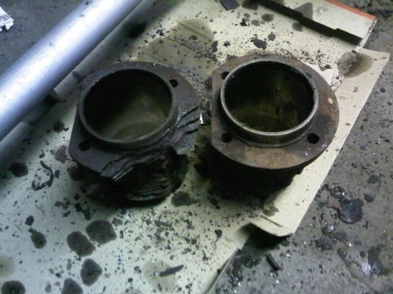

I dont think these fins will cool effectively anymore.... No I didn't break them they were badly rotted.
Test fit some 7'' s for shits n giggles

Here's the P&C kit I was talking about....this is what I have in the 60...under $150.
Postby gonebuggy » Sun Dec 04, 2011 6:56 am
Aaron,
those crack between the valve seats are a notorious problem. Take an intake and exhaust valve out and check for guide wear as specified in the Bentley repair manual. This will help to determine the life they've had. The closer to speck, the younger the heads. If they're near the high limit for wear, maybe consider some new heads. The cracks aren't usually enough of an issue to cause a dropped seat. Don't attempt to repair them, that will only exacerbate the issue.
There's a LOT of missing surface area on those P&C. On a Beetle, you might get away with it. Not on a heavy bus though. New P&C time #-o
Check the endplay, change the fuel pump, oil pump, generator tower gaskets as well as the oil cooler seals and rock it.
If you need any specs, or to borrow any measurement or engine tools let me know dude.

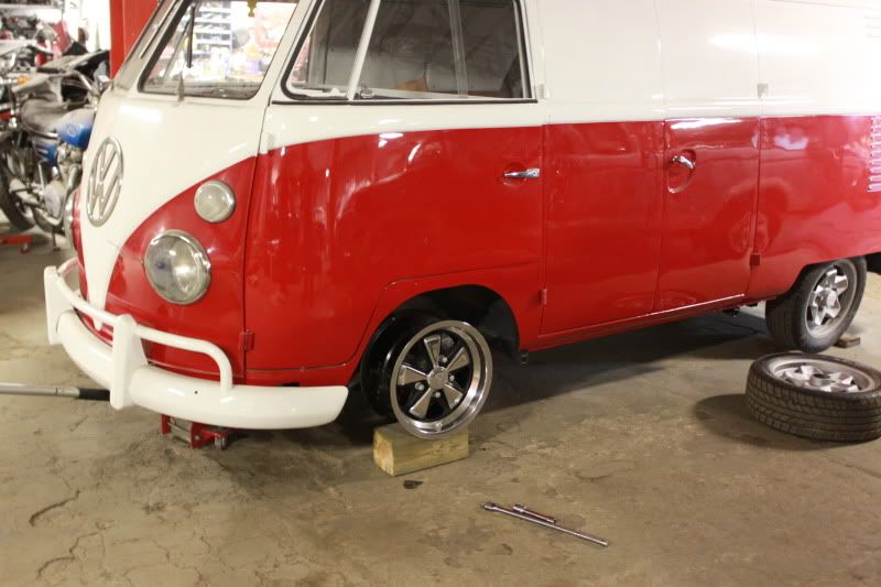

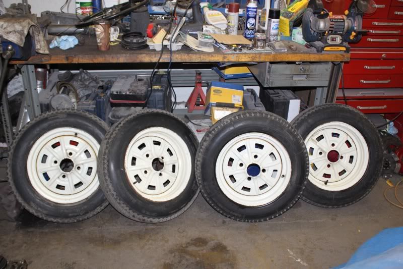

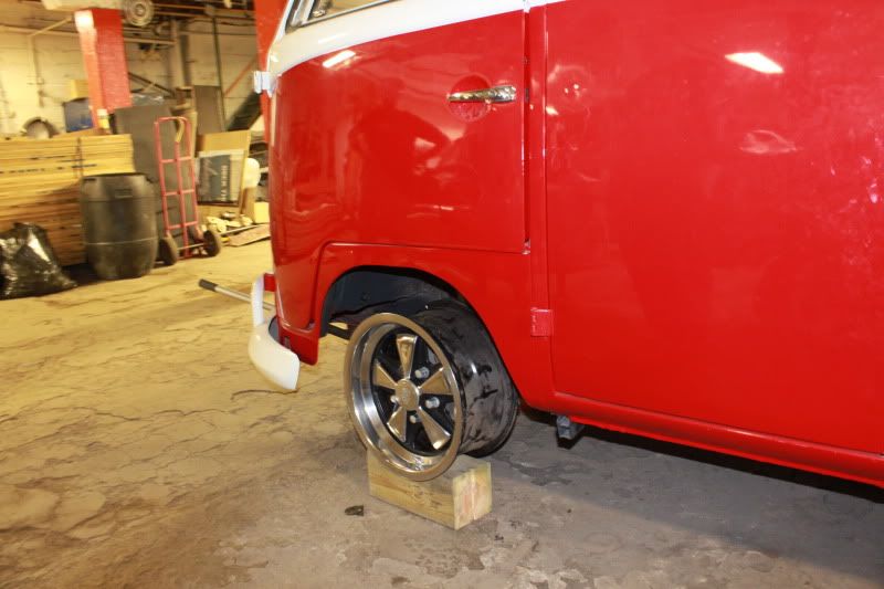

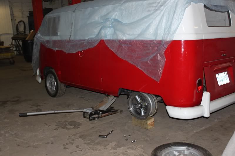

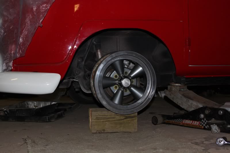

I messed around with a couple sets of wheels today .
These are the wheels I would like to run but it's going to be an issue to make them work in the front .. 14's FTW!
and last but not least if anybody knows someone who is looking for a set of 15'' 4 bolt Empi Lemmerz Sprint stars (staggered offset) let me know as I'm going to sell mine.

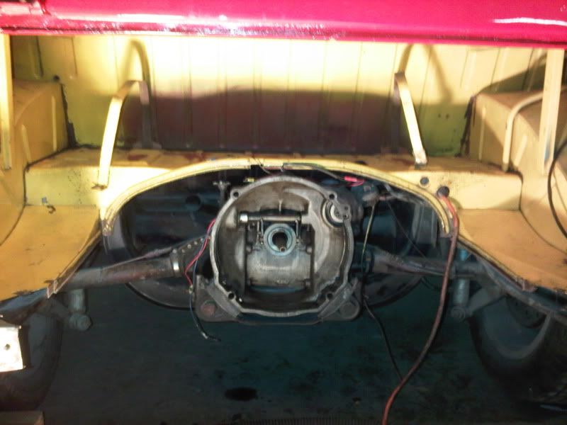

Started prepping the engine bay for the monster today. The yellow will be all but gone after some seam sealing and clean up.
Yes thats OG ruby Red poking through the firewall!
Also got my tranny #'s so I can figure out my throw out bearing set up for the type 4.
If anyone has a splitty gas tank kicking around please PM me or post up in here. Im in need.
