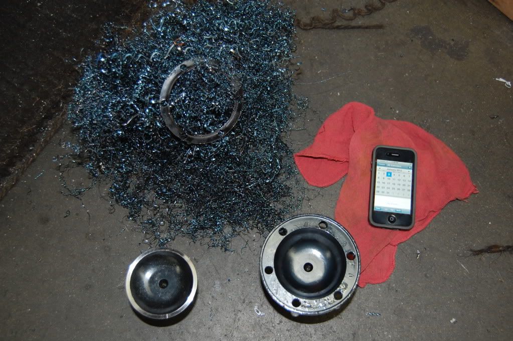

I didn't get much done but I did manage to take a perfectly good brand new 930 Microstub axle and turn it into steel wool.
And it took a long time.

bolt-on IRS?

Postby Old Speed » Wed Jan 04, 2012 9:09 am
early stages all over again. IRS kit but still requires welding the two small off road pivot sockets.
The shop is busy and we're going to Glamis the 14th. All the off road toys need work too so the 57 won't get much love in January
