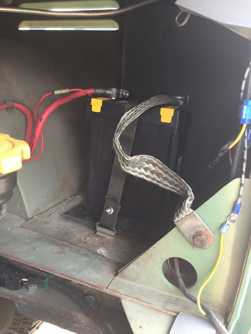

Just installed today. Smart battery from Indura Power. About the size of a large motorcycle battery. Has a bunch of options you control through an APP on your phone. You can preheat the battery for cold morning starts, turn off for security, monitor voltage available, configure for mounting upright; flat; or side, and a few other things. All LiPo, and has 550 cold cranking amps. I get this one for free to beta test. I like the part about turning off for security reasons. I know, if someone wants my bus, they'll get it, but it may stop a joy ride on a whim.
