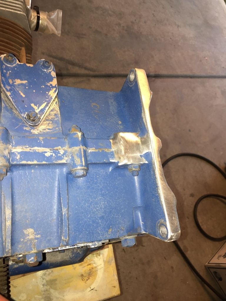

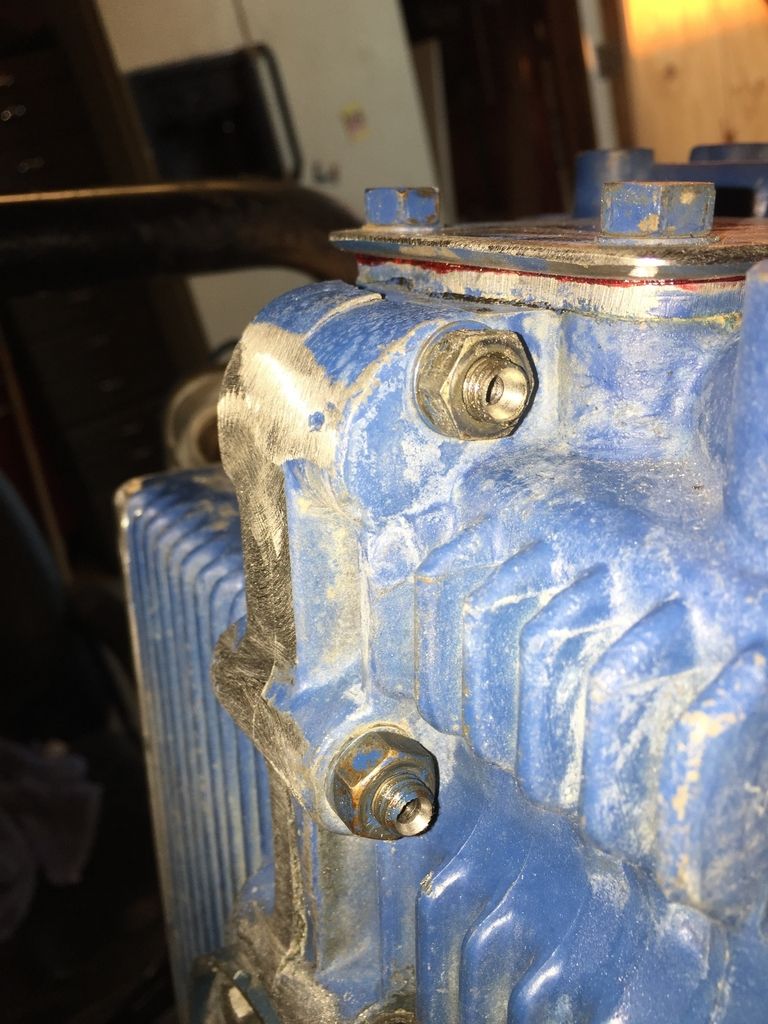

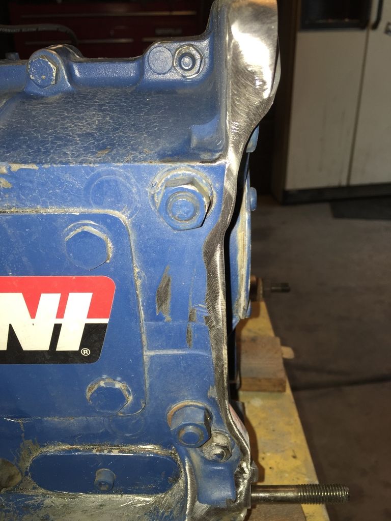

Played with my 1/2 VW engine yesterday. Did some out side the block lightening. Cut off the bell housing, all the big lugs I could get a cut-off wheel near, took the rim off the oil pump plate, shortened all the 8mm studs I could reach, and through drilled all the bottom 8mm case bolts. I think I lost about a pound and a half according to my bathroom scale. I will finish the upper case bolts today. About all I can do externally. I'm going to tear the engine down and do some internal stuff to. But that will be later down the road. Kind of want to run this puppy again real soon.

interesting... Are those 8mm bolts drilled out going through the case?

Yes John. They go all the way through. If I drill out anything going inside case, I would do very care full depth measurement to insure not going through and causing a leak. I'm only doing on non-load bearing bolts.
As for grinding off the fins, You would lose oil cooling ability.
