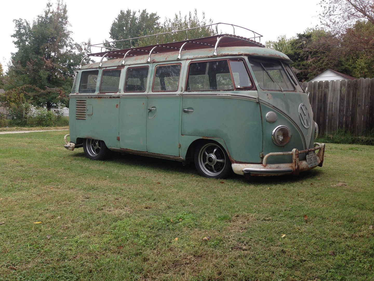

Postby squareonair » Thu Jan 05, 2017 10:10 am
last Nov its been 5 years ive owned this bus and drove it around tons of miles and long trips
it was time to change it up some

Postby GTV » Thu Jan 05, 2017 10:26 am
That looks SO much better. Those Beetle white walls were not doing it for me. What's the specs?

Postby squareonair » Thu Jan 05, 2017 10:29 am
GTV wrote:That looks SO much better. Those Beetle white walls were not doing it for me. What's the specs?
Front
145/65/15
15x4 inch wheels
2.5 narrowed front beam
3.5 flipped spindles
1.5 raised steering box
drum brakes
Rear
195/65/15
15x5.5 deep wheels
3 inch narrowed rear torsions
long axle/long spline axles
short axle drum brakes

Postby GTV » Thu Jan 05, 2017 11:23 am
That's got some meat out back!
They both look killer.

Postby squareonair » Thu Jan 05, 2017 11:26 am
GTV wrote:That's got some meat out back!
215/65/15 on the back of the 23

Postby Franz » Thu Jan 05, 2017 12:53 pm
Sweet buses Patrick. =D>

Postby jb » Thu Jan 05, 2017 1:12 pm
Franz wrote:Sweet buses Patrick. =D>
I'll quote that!
Is the red one narrowed torsion too?

Postby johnnymain » Thu Jan 05, 2017 1:54 pm
Fucking killer set ups!!!!

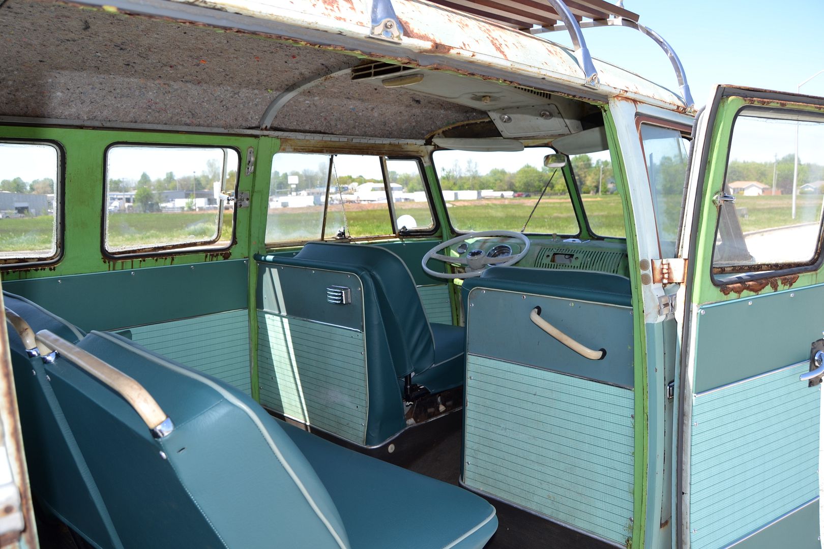

Postby GTV » Thu Jan 05, 2017 1:55 pm
squareonair wrote:Image
I just noticed this bus has thin lipped dog legs (63 and later) and flat rear fenders (62 and earlier). Must be a transition bus? Would you mind sharing the build date?

Postby squareonair » Thu Jan 05, 2017 2:56 pm
thanks
jb wrote:
I'll quote that!
it is not narrowed..it has offset spring plates on it
June 02 1962
its a one year only walk thru with short seats and the drivers adjust mounted on the side
