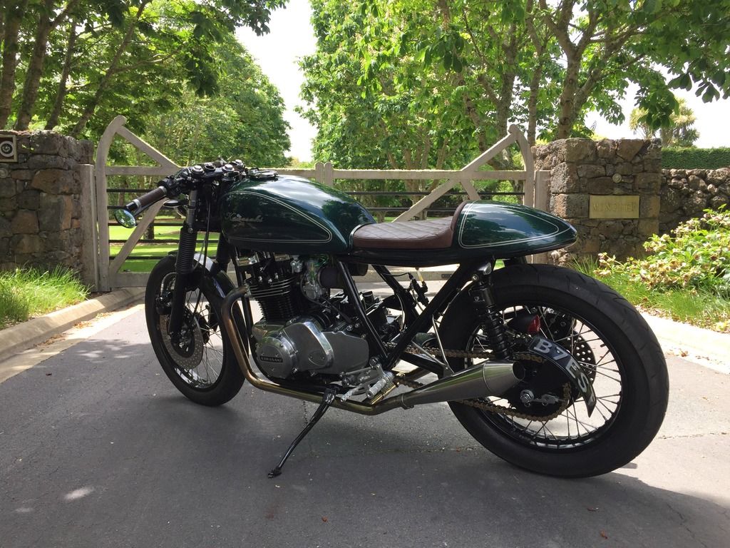

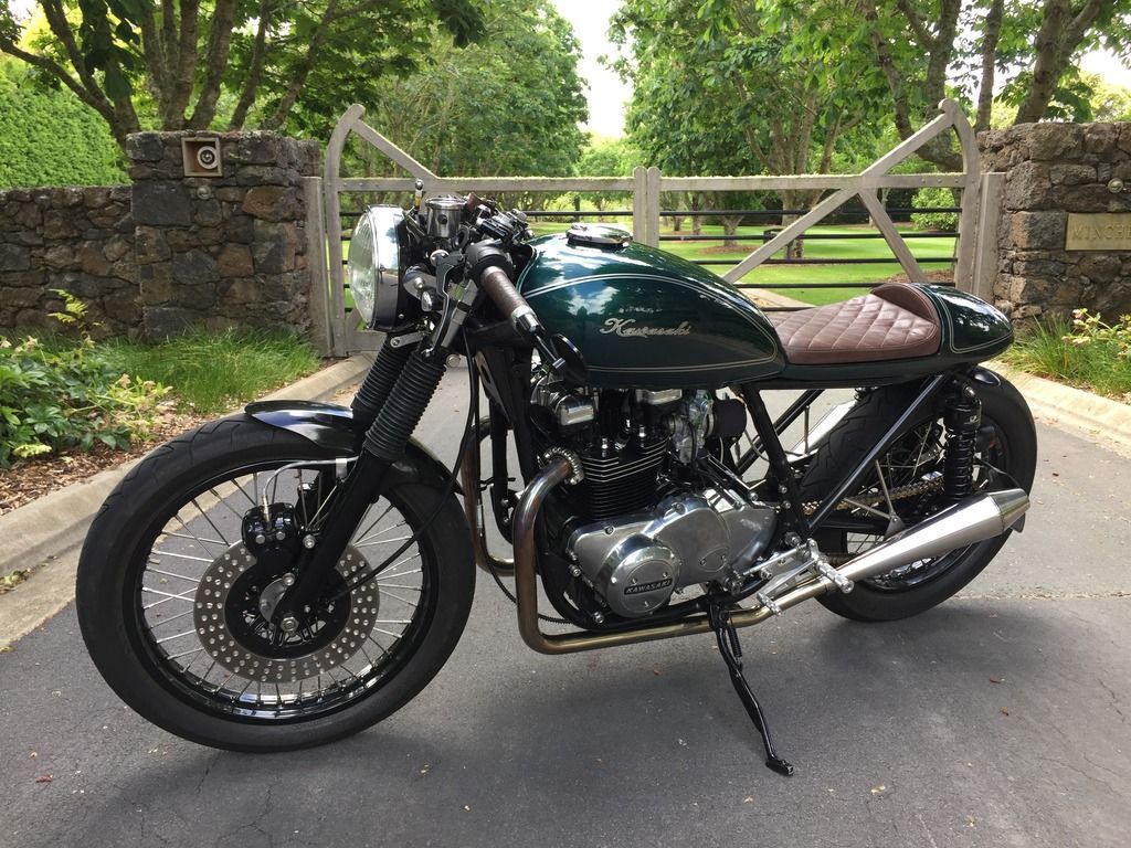

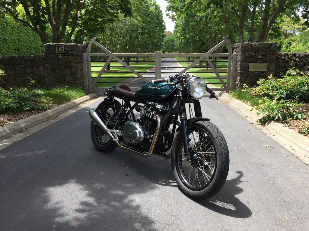

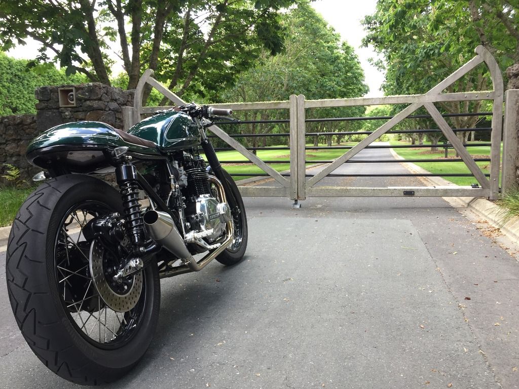

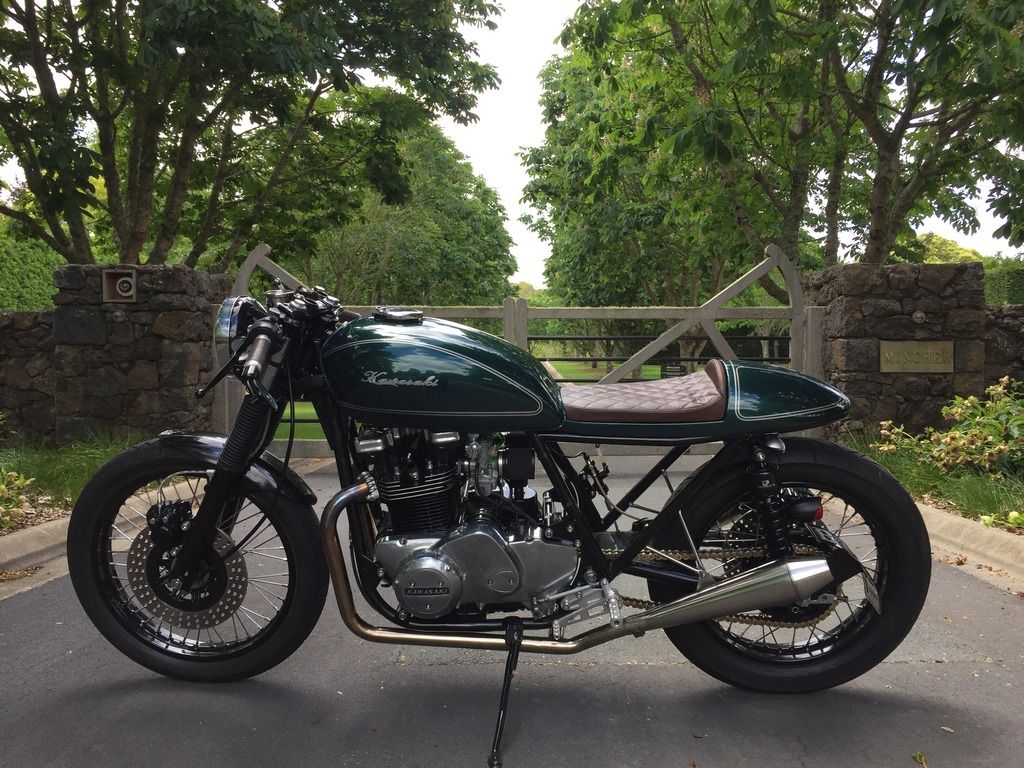

Just finished this build after 2 years, first time it's been on the road in 10 years.. Big change from what i was, its a 1978 kz750 twin, not a common bike...Fun to ride, loud and raw. Pretty happy with how it came out, the original bike was an absolute mess, so its been a pretty full on project to get it to this stage.

Noice!!
Gotta be happy with this Kwaka =D> =D> =D> =D>
KIM -----------------
" whale oil beef hooked "
http://www.chalkboards.com.au
Posts: 1591
Re: Motorcycle Racket
Postby K Leake » Sun Nov 20, 2016 7:07 am
The bike looks awesome. Love the cafe racer look. =D> =D> =D>
Posts: 6180
Postby rustabus » Sun Nov 20, 2016 7:28 am
Great looking bike!!!! =D> =D> =D> =D> =D>
Posts: 1604
Postby vwfool » Sun Nov 20, 2016 7:51 am
Beautiful =D>
Posts: 1807
Postby George » Sun Nov 20, 2016 8:06 am

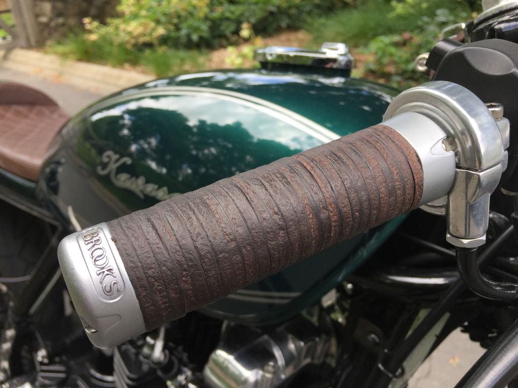

Well done I really like the grips, looks like a fun ride. =D>
Posts: 20025
Postby Franz » Sun Nov 20, 2016 8:38 am
Beautiful =D> Fun to ride?

Nice! I love the grips too. Looks like individual leather doughnuts stacked end to end.

BBWB wrote:Nice! I love the grips too. Looks like individual leather doughnuts stacked end to end.
When I was up there, there was a KZ750 in that yard right across from the gas station on 7th ave. Still there?
That's exactly what the grips are, like an old knife or hatchet handle. Very Kool!

Nice! =D>

Thanks guys, I'm really happy with how it came out. Next on the list is a 70's Moto Guzzi I think.
The Grips are Brooks cycling grips, and yep they are punched out leather rings stacked together, had to open out every ring and the aluminium end clamps for the throttle tube.
Its really fun to ride, extremely loud, good fun amongst traffic in town and in the twisties, no so much fun on long straights.
Trying to dial in the Mikuni carbs, have a strange surging problem at idle, cant find any vacum leaks, thought normally surging was a lean condition, but the plugs are reading rich, might go down on the pilot jets and see. Still waiting for rings to settle in, so will give it more time first.
