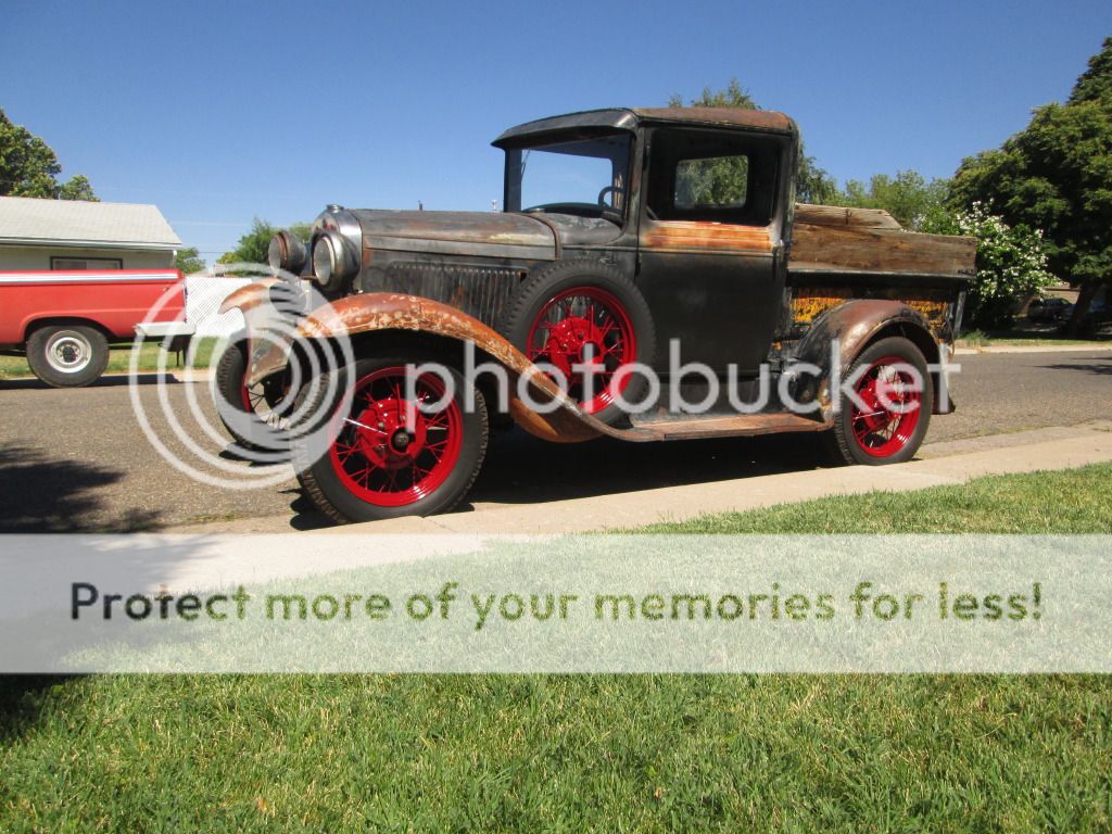

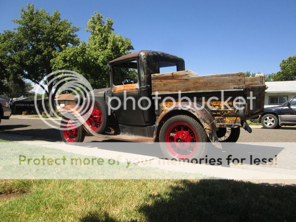

Today is the first of July. I met my goal 100% and then some. I did a ton of work on this rig...twice what I thought it would take. Here is a list of the work accomplished in the 30 days:
- good cleaning to remove all of the farm dust, and barn residents.
- Mavel oil'd the shit out of the engine
- cleaned the entire fuel system
- rebuilt carburetor
- new coolant hoses
- new battery
- blasted, straitened, and painted 5 wheels
- installed new tires from Coker.
- blasted and painted drums
- rebushed the brake master shaft
- replace as necessary and packed wheel bearings
- cleaned/lubed brake shoes/mechs.
- adjusted brakes
- greesed chassis
- changed all fluids
- flushed radiator/engine
- blasted, painted, and installed new manifolds with new gaskets.
- faux patina on doors as per Rusty's request
- reinstalled floor, seat, bed sides, and tailgate
That took me a minute to think through! In one months time I took this truck from barn find, to road worthy....while working a full time job too. My part of the deal is done, and I'm ready to give the truck back to the 82 year old man that owns it. I hope he can see and appreciate all that I did. Its a really neat old machine...the oldest car that I've ever driven. I'm excited to give it back.
