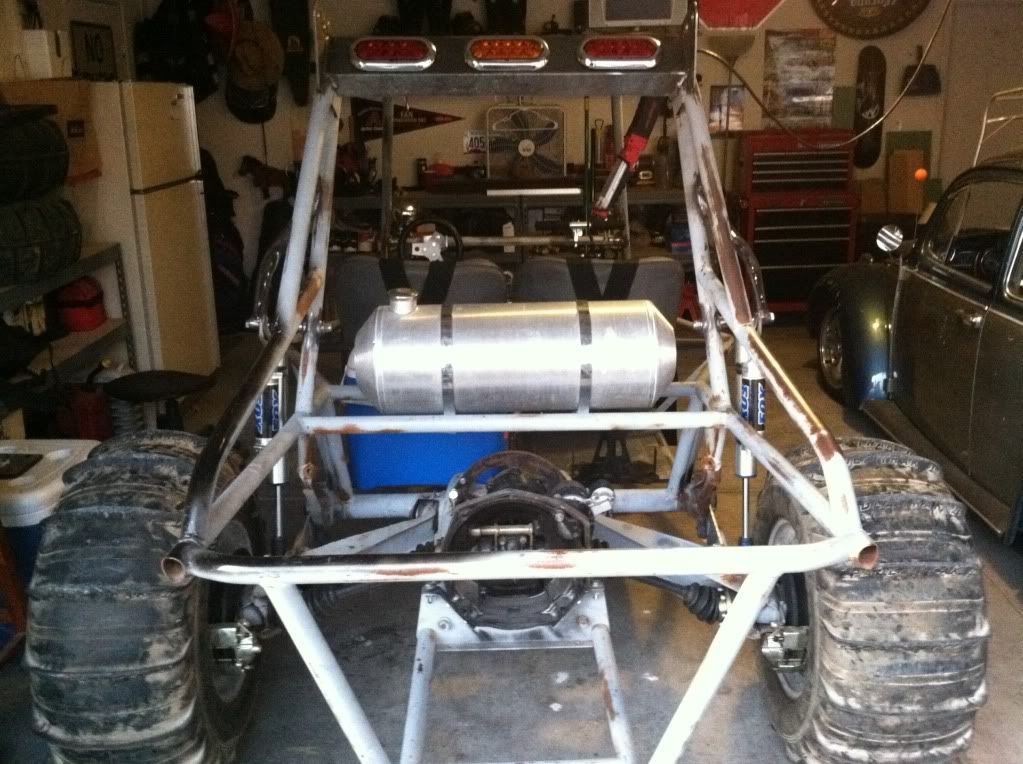

Here's how I found this baby about 3 years ago:

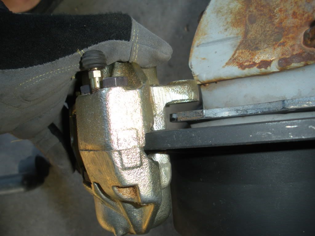

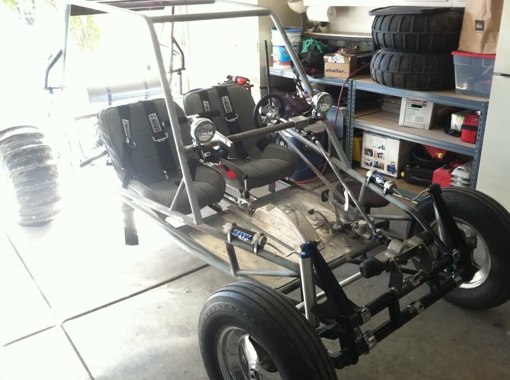

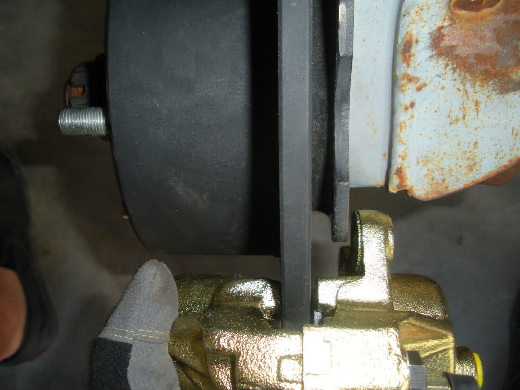

I work for the an engineering consulting firm and we do stuff for the mining industry. Anyways, I go get to travel a lot, so fast forward about 6-7 months till I got a chance to start playing around with this. First stab at the rear suspension included new disc brakes, new bearings, and rebuilt/regreased CV joints. New Fox shocks with external reservoirs on all corners. Transmission was just cleaned up, it's supposed to be a sand tranny, but I guess I'll know when I take it out.

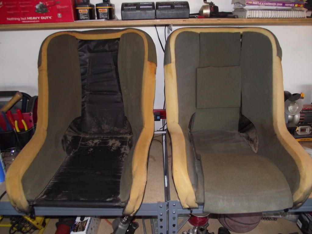

Got some used bucket seats and had to clean them up and rebuild them. Painted the frames, used the existing cushion where available, rigged up cushions where needed.

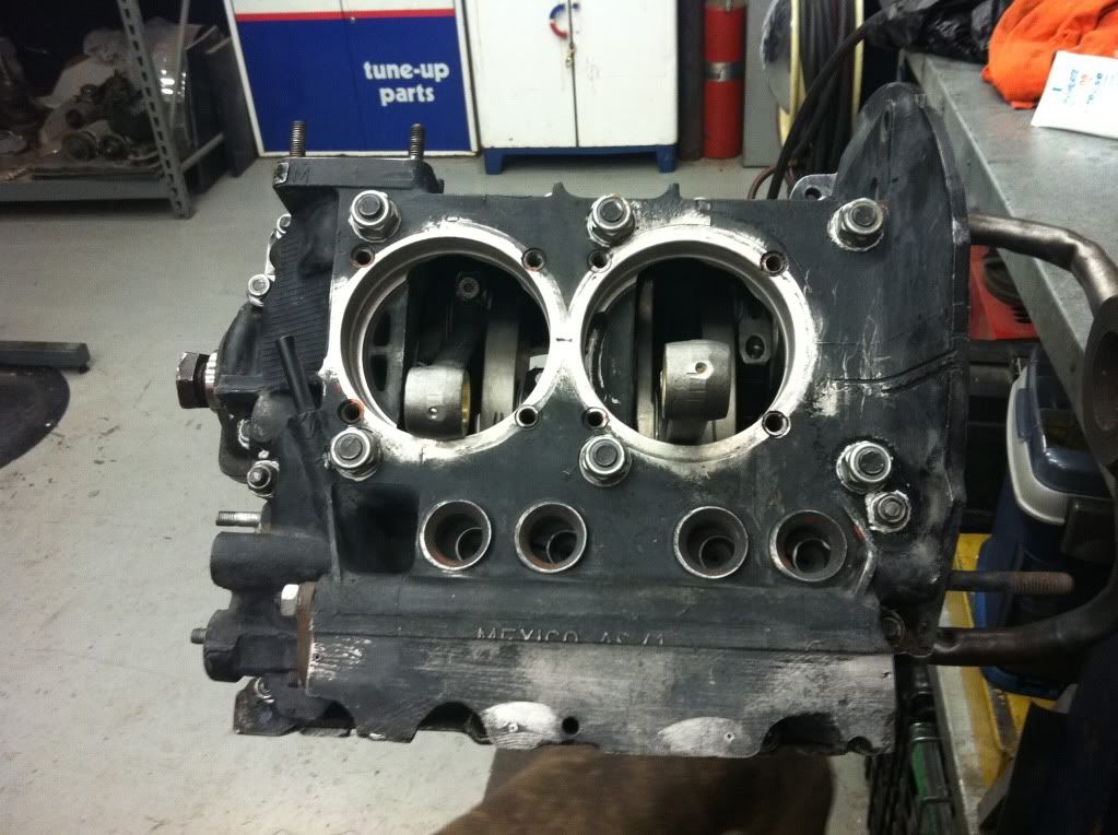

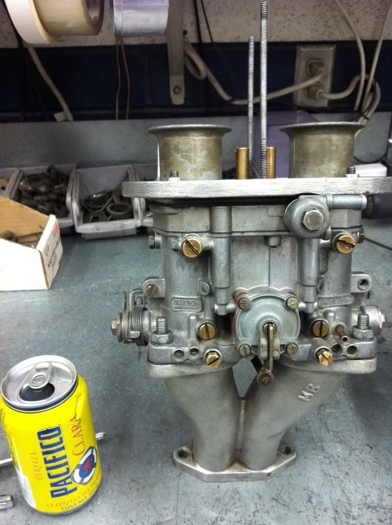

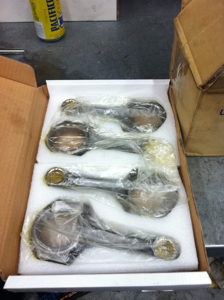

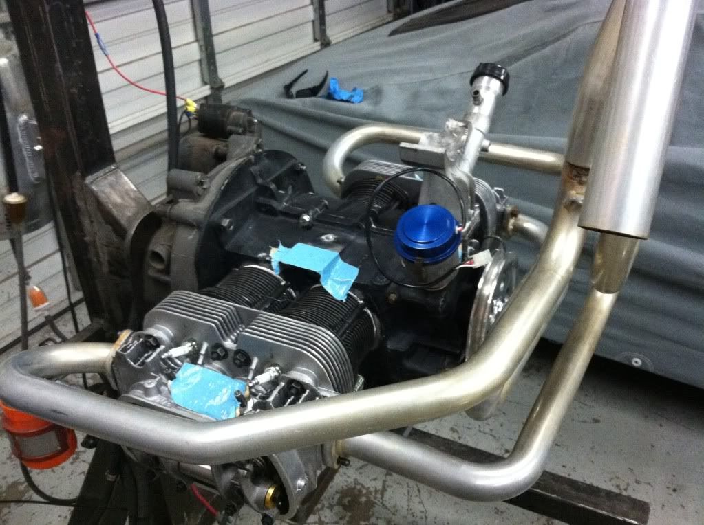

As for the engine, I built (with the much needed guidance from by buddy Brandon from Speedshack) a 2110 with 36 Dells. Started out as a 1915 rebuild, ended up with a 2110 and all new parts internals. only thing not new on the longblock is the case (which I now wish I had replaced for peace of mind). Some pictures of the engine build:
Got some old-school KC lights which I plan on using, put I am thinking about maybe getting something more modern.
Grinded off the super lame adjusters that came with my Warrior/China beam, to put the adjusters I bought from KCW a few moons ago. By moons I mean months if not over a year [-(

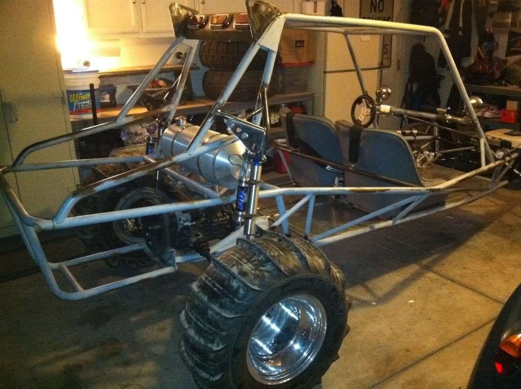

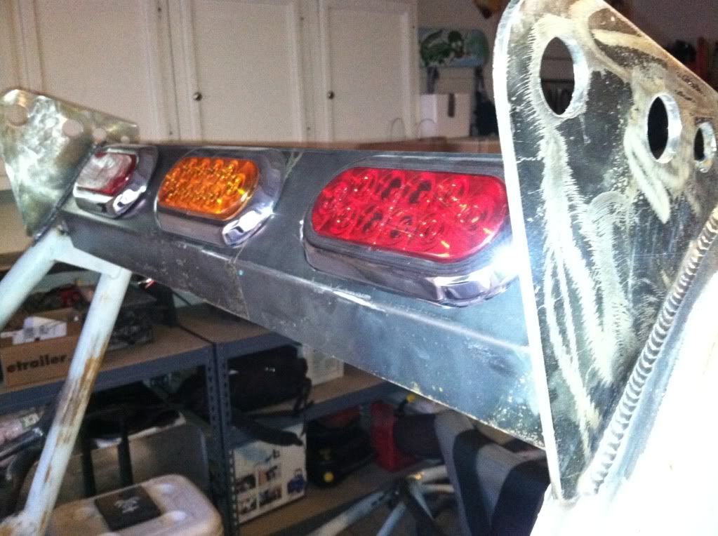

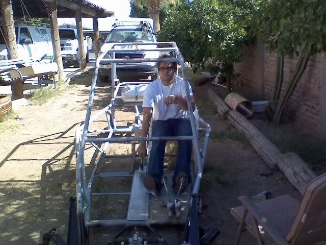

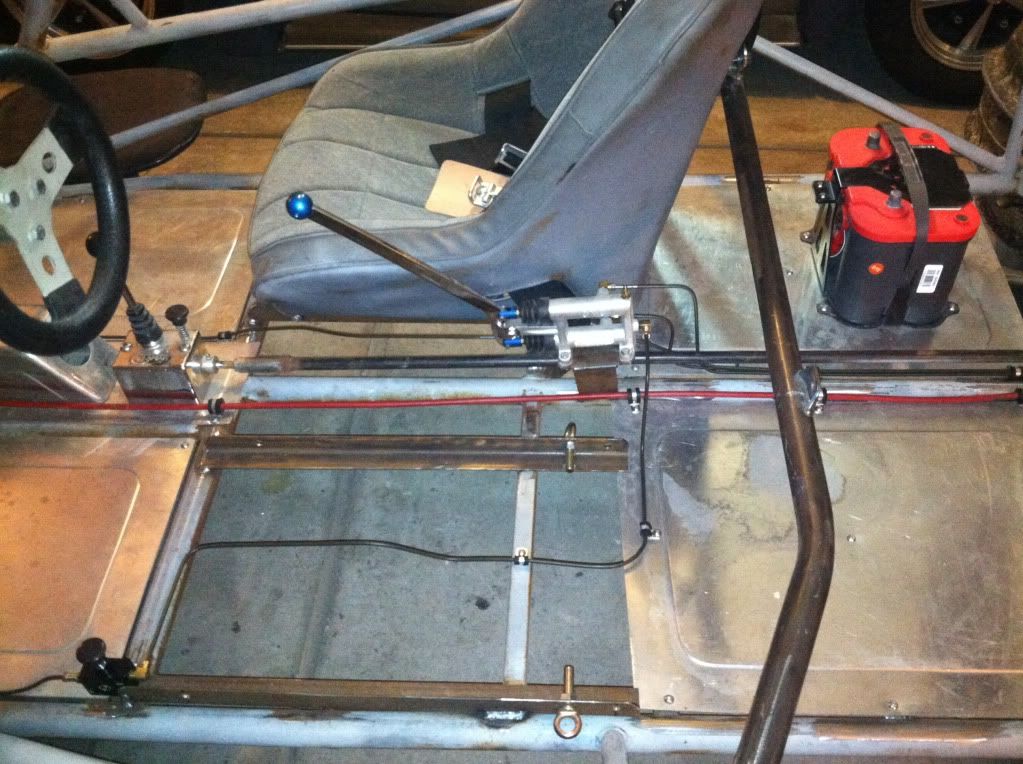

Fast forward to a few months ago, I took this over to my buddy that does some killer welding to weld the front beam adjusters, move the seats back 6 inches to make this a comfortable two-seater (instead of a crowded 4 seater), weld some tabs, and fab up a thing to mount my rear lights. Here's where we're at now.

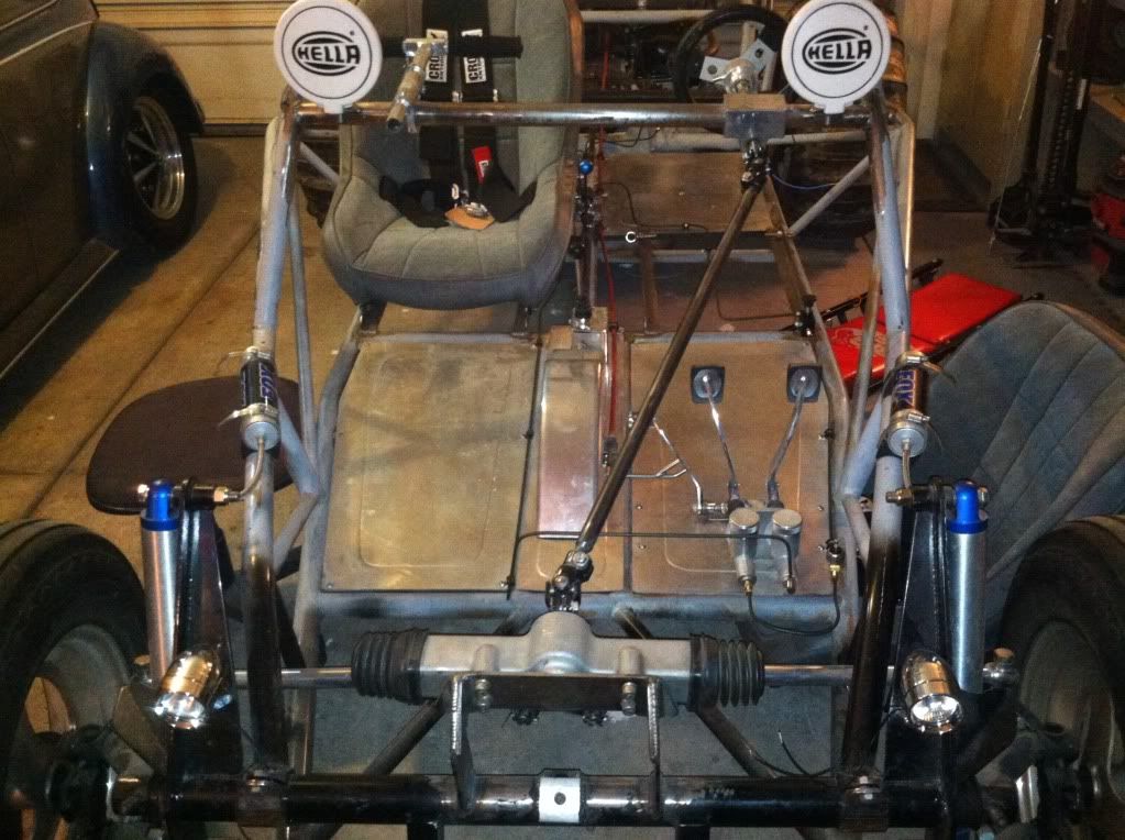

Got a head start on the brake lines. Not much done yesterday, stayed late at work. My K-Four switches were delivered to my work this morning, I know what I'll be doing this weekend.
Dry Heat Panzers - Established 2003
https://www.facebook.com/DryHeatPanzers
Omar67
Posts: 494
Joined: Thu Feb 10, 2011 3:23 pm
Location: Phoenix
Postby Omar67 » Mon May 07, 2012 4:06 pm
Got my brake lines and clutch line done over the weekend, as well as the accelerator cable. I also installed some bullet lights on the front beam, and replaced my old-school KC lights with some newer Hellas. Battery is in as well (did that the other night but forgot to mention it).

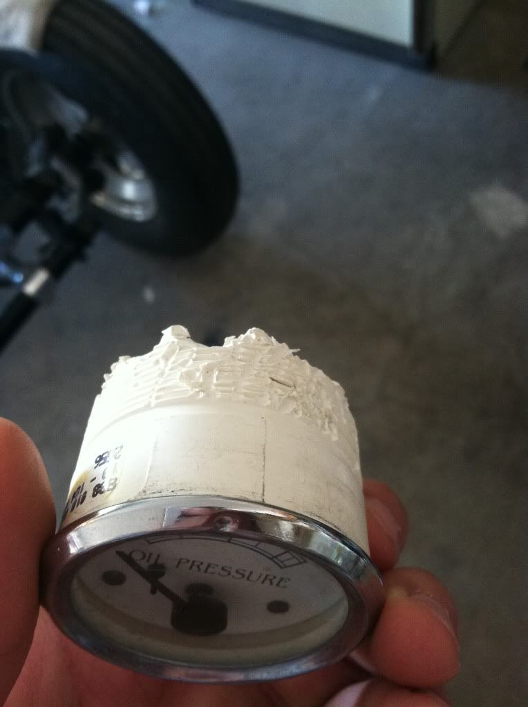

I have some Royal Cockpit VDO gauges that I was going to use. I actually don't like them much, specially for my rail, but I had them so I figured I would just use them. Well, my dog thought one of the gauges was a chew toy, so I might be replacing the gauges altogether now ](*,)

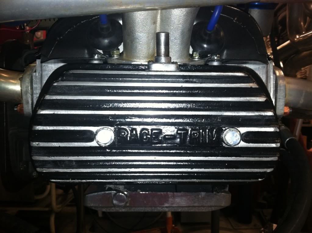

Took the engine out tonight to drill and tap the 1.5in tube behind the engine to mount my Compu-Fire and my breather box. Ended up not trusting the tube to be thick enough to have enough thread, so I drilled the tube through and used longer bolts.

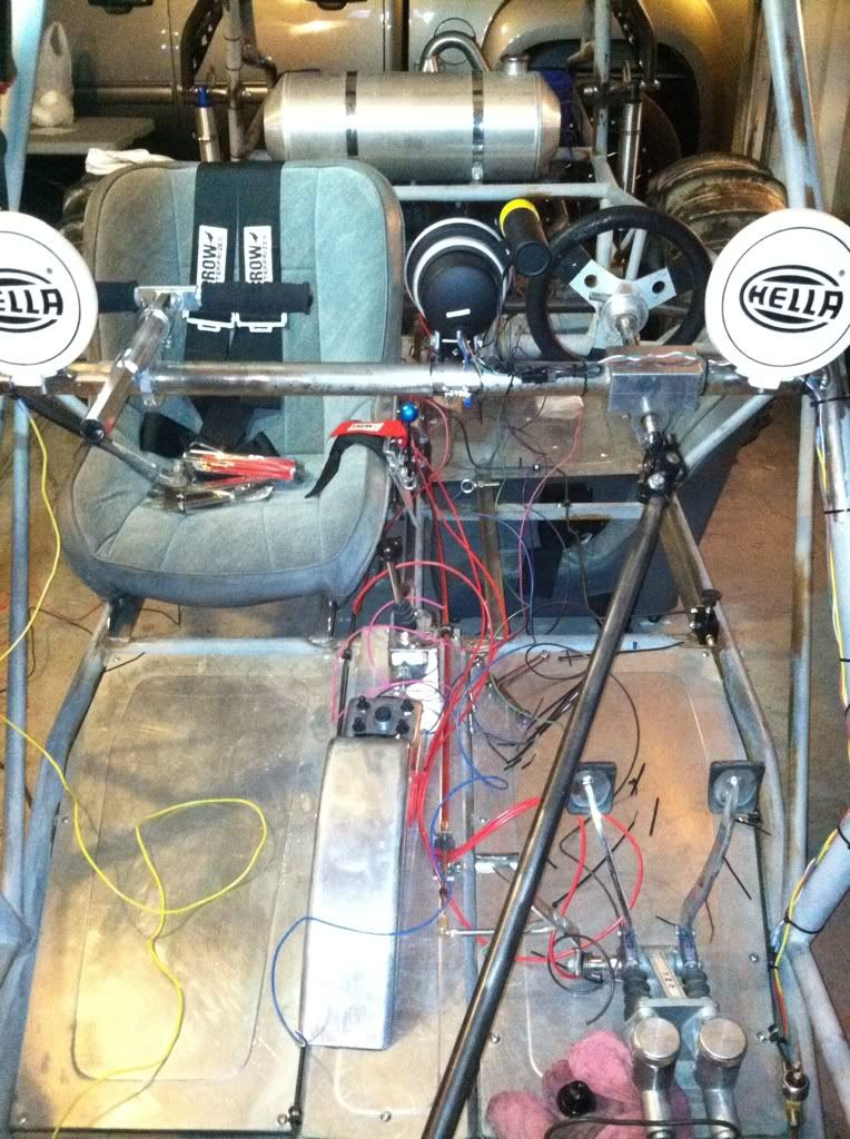

Postby Omar67 » Sat May 19, 2012 11:57 pm

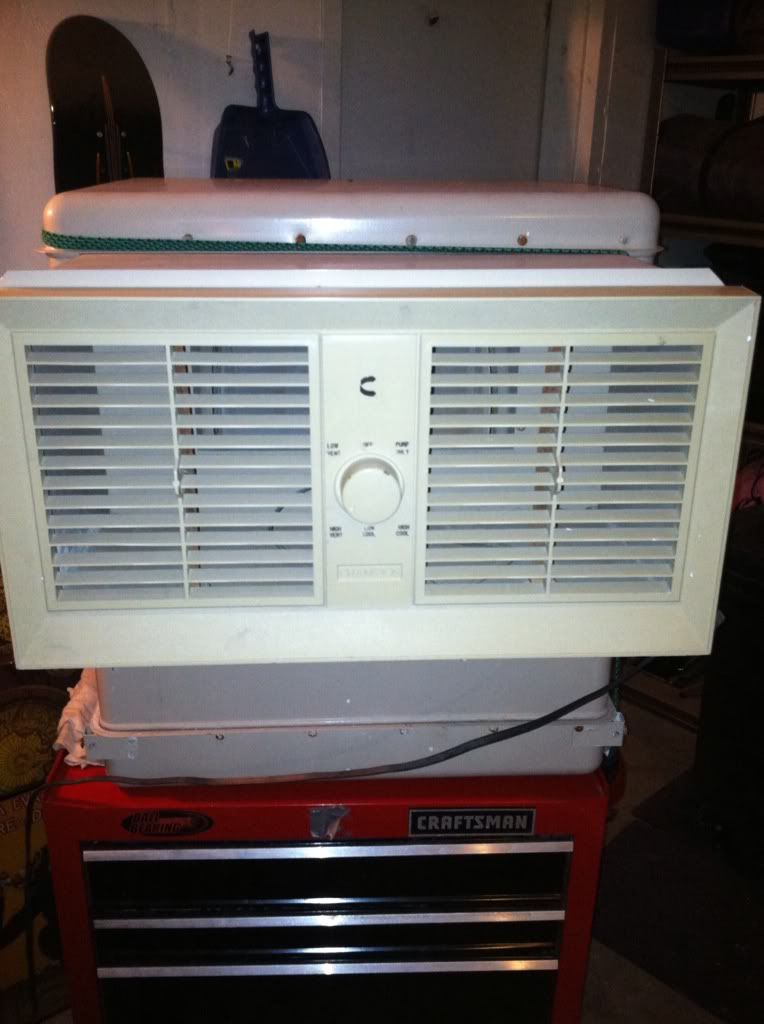

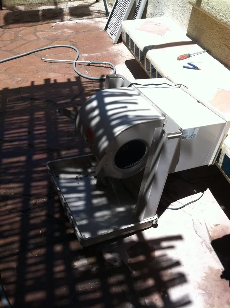

Today was a pretty eventful day. Woke up and took the dogs to the dog park, ran for a little with them and realized it was going to be a hot day today. So I decided it was time to fix up and old swamp cooler I had laying around. Took it apart, cleaned it all up, and put some new pads. Took up most of my morning but it was well worth it.
After I had some nice cool air flowing in the garage, I installed a new throw out bearing and put the engine back in. Man, it's so much easier than in my bug. Got some more stainless bolts, god they are expensive and add up quick. At this point I don't even care, just want this done! Mounted my tach and flag mount.
Now I'm in the middle of the wiring... A lot more tedious than I ever expected. Got a clusterfuck of wires, at least I'm using different colors to help out in the end... I hope. Here's where I'm at right now...long night ahead.
