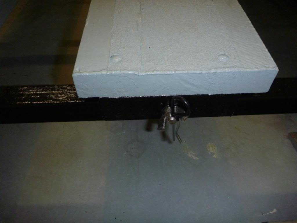

I had some anti skid additive left over from another project so I mixed it with some gray floor paint. Applied it down the center of the runners.
Literally poured it out of the mixing can and used a throw away roller to spread it out.
Primed and waiting to dry.
Runners turned out pretty good. Took two coats to get desired texture.

I used 1/2 inch stainless bolts run through the rear cross member and welded in. Hole drilled for retainer pin and wing nut to hold tight. This holds the rams in place in the rear. Bungee cords or straps keep them from bouncing around up front.
