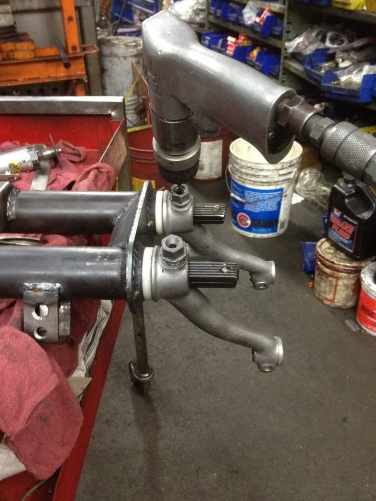

Using center drilled lug bolts to mark the dimple locations. First I set the offset of the upper and lower arms before tightening the lug bolts

Postby Old Speed » Sat Jan 21, 2012 2:26 am
small bit
big bit

Postby Old Speed » Sat Jan 21, 2012 2:35 am
Well that's as far as I got. I still need to paint and install, then do tie rods and pitman arm.

small bit
big bit
Nice work =D> You can definately tell you take pride in your work! way better than what I found on my panel's beam when I disassembled it last summer

Postby Old Speed » Sat Jan 21, 2012 11:17 pm
Thanks
It's pretty easy to sharpen the drill bit to match the set screw angle with some eyeball accuracy
In your case it will be easier to use a ball end carbide die grinder bit to realign it where you want it since a drill will follow your existing dimple

Postby MichaelDF » Mon Jan 23, 2012 10:45 am
Old Speed wrote:Image
I learned something new today. This is brilliant.
