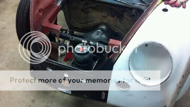

Postby DaKine » Mon Jan 30, 2012 5:55 pm
I don't know shit about air ride suspensions and learning alot from your build. =D> I want to try it out in my next build. Are you going to have to cut sheetmetal to use the center mounted bag? I was watching this guy's build on samba...are you going to have to hack the spare tire area like this or is there an alternative besides staggering the bag? What's the advantage of a center mounted bag?
slammed and shiny
Posts: 1167
Location: Riverside CA
Postby slammed and shiny » Mon Jan 30, 2012 8:46 pm
idk shit either but to me that looks like it would lean like crazy in the turns.
BEANS
Posts: 212
Joined: Mon May 01, 2006 5:18 am
Location: Pittsburgh, PA
Postby BEANS » Tue Jan 31, 2012 7:12 am
I didnt even see that build thread. Do you have a link? That is basically the same thing I'm doing. Its very similar to the way guys bag type3s. I dont plan on cutting out as much sheetmetal as he removed in that pic above, but yes the spare tire well will be cut.
I've built a few passenger side mounted bag beams, and just never loved the setup. I know they work, but I'd feel alot better about having the bag center mounted, and the forces evenly distributed across the front end parts. I'm willing to sacrifice some sheetmetal for this, which wont work in most peoples cases. I'm starting out with a front apron/sparetire well that is pretty much rotted away. I wouldnt do this setup on a clean oval...
If I can push the bag out a little further, I'm going try and mount a shock between the bag and the beam. Having it attached to the lower bag bracket, and the moving brackets that attach through rod and bag. I have to make a trip over to my parents as I have a few shorty shocks I picked up at a swap meet. If not I may just spec it out and order one.
Edit: and not critiquing the pic above, but I can tell that the bag would bind up a good bit if he had it lifted up. Looks to me like it is on jackstand currently with the suspension dropped out, which is why the bag looks like it is almost in the "perfect" alignment. Where he has his connection point on the bag side should be more centered on the bag to minimize twisting when pressure is applied. I've done enough custom airride setups in the past 10 yrs to know what will work and what wont. I started out using parts from local airbrake supply companies and having my brackets punched out using AutoCAD files I did at home. That was before any of the big name players made nice bolt on kits for trucks and cars. We had to make everything, and make sure it worked. A ton of trial and error.
