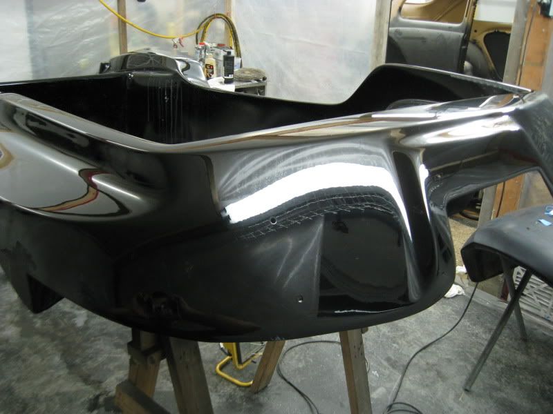

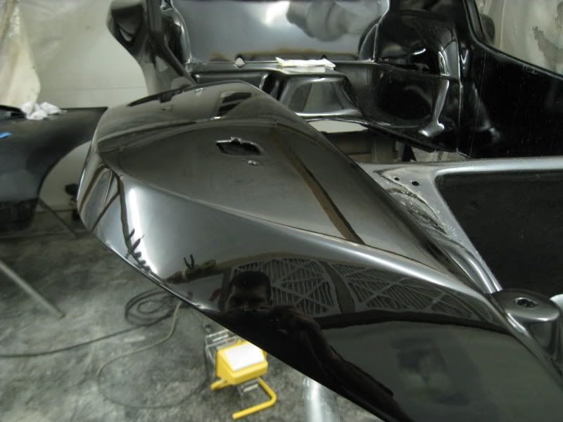

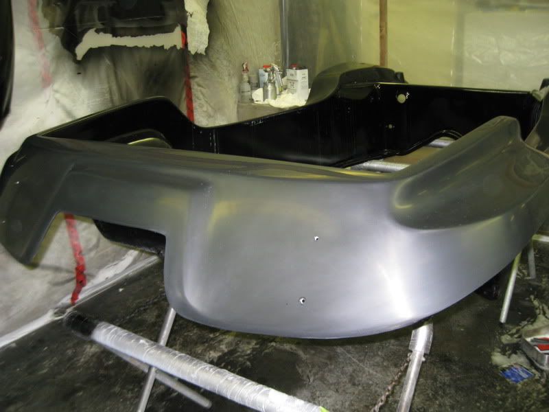

Posts: 4097
Postby jb » Tue Apr 10, 2012 11:34 pm
Borrowed a buddies big ass Makita polisher.....man that thing is a killer tool that I have to buy!!!!
before shot....
took some pics of the sanding blocks I made for wetsanding.....mostly wetsuit neoprene glued to either thin flexiable rubber gasket, some with plexi glass sandwiched or glued around piece of 1" pvc for inside contours. things worked fucking awesome! Smile
lots of hot soapy water and a whole shitload of rubbing later......
Shiney again......and deadly flat!!!!
that was only about 2 hours total polishing first on the wool pad and then a quick go over with a foam pad with same 3m compound, gonna do the finishing glaze tomorrow \:D/ \:D/ \:D/ assembly soon
