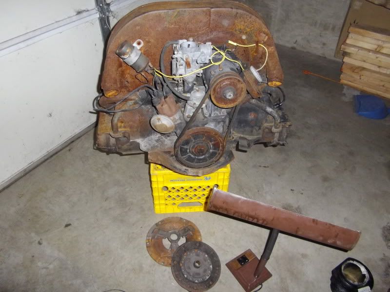

As promised, Mike!

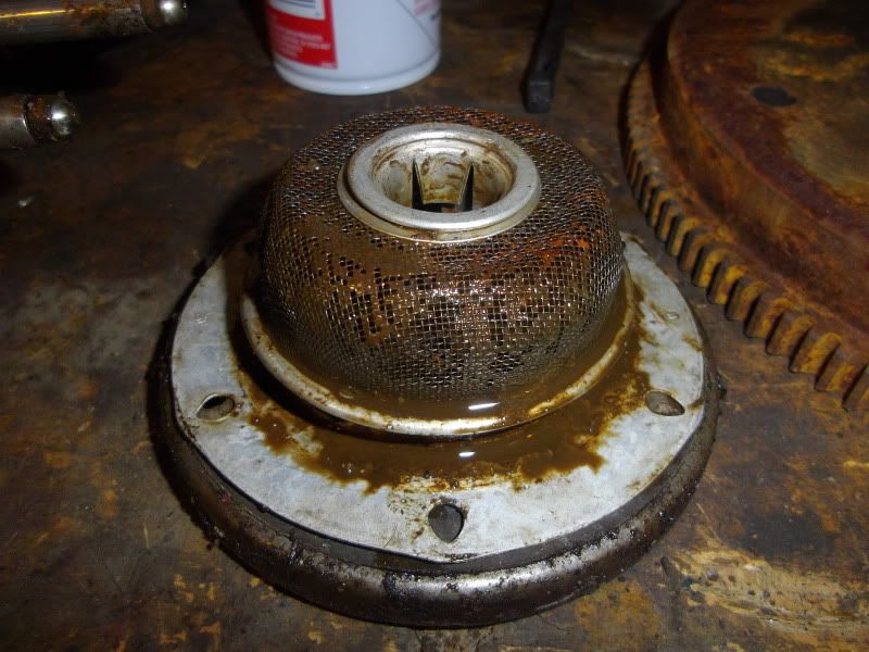

So, the disassembly begins. First thing's first: Drain the oil.
You may find yourself questioning, "What is that brown stuff?" That, my friend, is mud. A lot of mud.
A lot of mud.

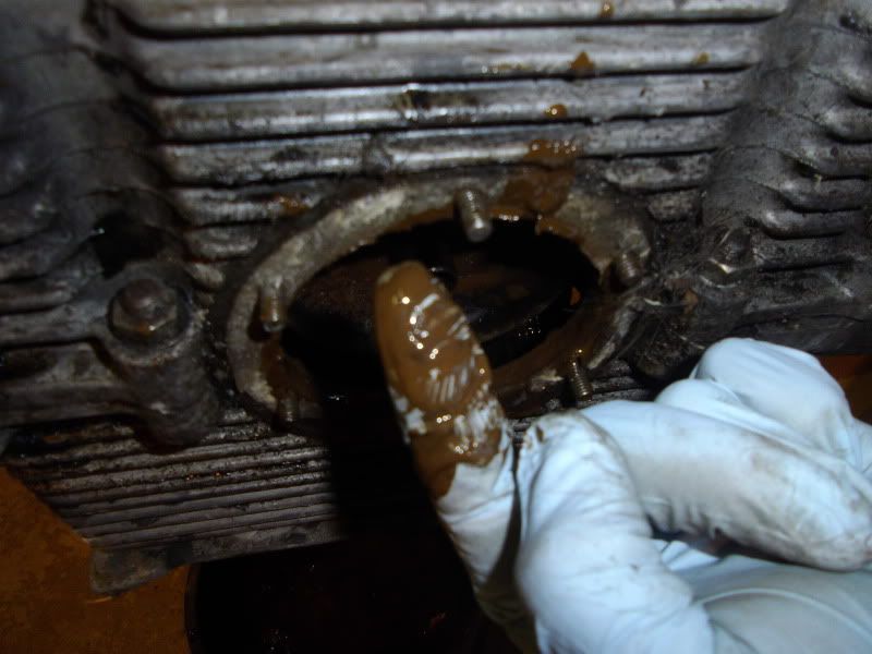

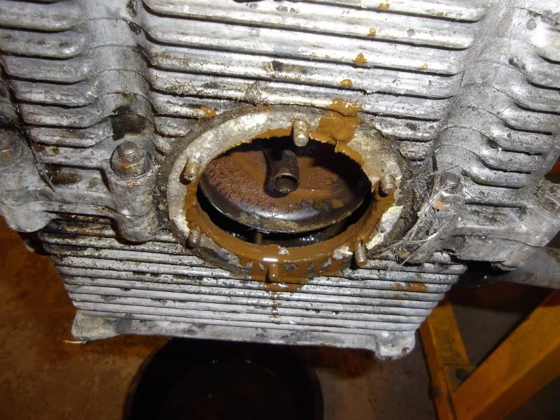

Had some water in the cylinders. Not too bad now, but needs a good cleaning.
Ohey look! MORE MUD.

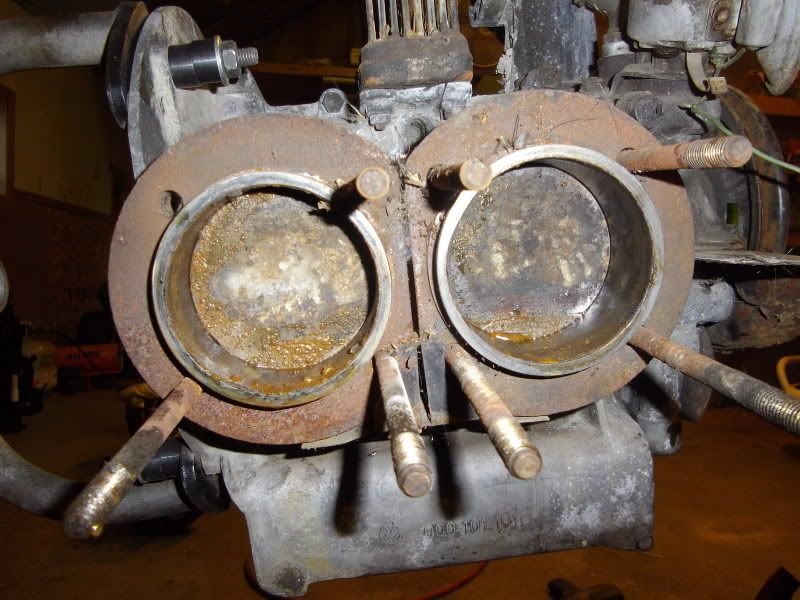

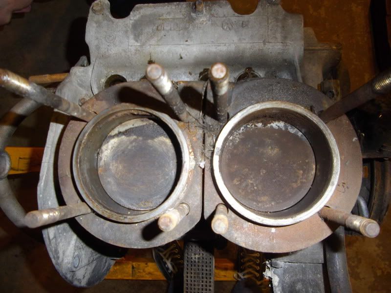

Mike and I decided that this thing, at one point in time, was greatly ablaze.
Judging by the engine tin, I'd say that probably wasn't pulled out and let sit because they wanted to put a V8 in their Beetle. Tomorrow, I'm gonna buy a big bucket of brake cleaner and let all my components and stuff sit overnight in it.

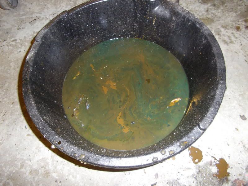

My whole rocker assembly is covered in rust. Reuseable, but not it the state it's in now. As for the case, this was Mike's idea.
Fill it full of Kerosene.
*slosh slosh slosh slosh slosh slosh slosh slosh slosh slosh slosh slosh slosh slosh slosh*
Drain the Kerosene.
Fill it with more Kerosene.
Drain the Kerosene.
Take it to work.
POWER CLEAN it.
So hopefully it works.

Postby dreadnotmusic » Mon Mar 14, 2011 7:02 pm
Great video, Jake! You did great on your first bay drive. My bus responded well to your touch =D>
http://www.youtube.com/watch?v=fST1LBXzHpo
My fingers are crossed for your engine. We'll see what comes out when I start sloshing around. I'm donating a new clutch, pressure plate, and flywheel if needed. If the carb is crap, consider that covered too.

Postby Schmitty » Mon Mar 14, 2011 7:08 pm
Thanks Mike! I think the carb will be fine. The jets aren't clogged, but it needs a good cleaning. Shoulda taken that home with me for a bath in brake cleaner! Take pictures for the mess that'll come out after the sloshing. I wanna see this.

good job, take my word though be careful of letting stuff sit in carb cleaner or brake cleaner over night. a good carb cleaner will eat a cast carburetor body if it is immersed starting after about 30 minutes. I promise i have done it before ](*,)

Hopefully that water didn't get to the bottom of the case and rot it too badly.

I think Jake is pushing 16 =D> I realized last night that I'm more than old enough to be his old man! First time I've given the keys to one of my buses to someone. It was a lot of fun.
Franz, from what I can see and feel, there is no rot at all in the sump. It feels solid and perhaps preserved by the layer of sludge/mud/oil/varnished gas that poured out.
The look on Jake's face when I told him the engine is toast and needed to be rebuilt was terrible. It made me agree to attempt the unthinkable....flush it and see what happens.
What do you think I should flush it with? It sat upright the whole time, so the junk should be sitting in the bottom only. Kerosene? Gas? Pressure washer? :-$

Postby dreadnotmusic » Tue Mar 15, 2011 3:14 pm
Jake,
First round of flushing done today. Nothing alarming came out. The engine turns over nice and smooth. There may be hope after all.
You're going to need new push rod tubes and a gasket set. That will have the intake, exhaust and push rod seals you need. Also, be on the lookout for a non-doghouse oil cooler. Not much reason to go through all this trouble and risk to blow the damn thing up right away by using a clogged up oil cooler. I have the seals, but all my coolers are doghouse style.
Get that stuff cleaned up and get back over here! Don't spend too much time on the rocker arms. We'll use my bench mount brass wire wheel on those.

Postby Schmitty » Thu Mar 17, 2011 7:49 pm
Just ordered a new set of Pushrod tubes and a gasket set from WW. I was gonna just buy the pushrod seals, but for some reason, WW doesn't sell them individually. :-k And I figured I could probably use the whole gasket set.
Hopefully they arrive soonish, I cleaned up my parts, and I'm eager to see if this thing will run!
