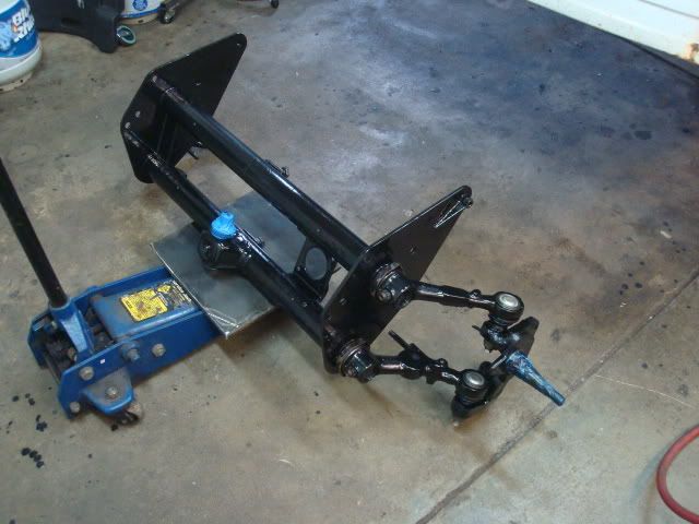

Finally got the beam pretty much built up. It is definitely as big a bitch as everyone says.
Thanks to DetroitJohnny for the plates, they worked great.
I wound up TIG welding the whole thing. Mainly because my MIG sucks and I need the practice.
Went with Nate's "Beefcake" adjusters

Yea I don't think that's going anywhere. Looks awesome.

Here's the completed front beam. I sand blasted the control arms, replaced the ball joints, and POR-15'd everything. I wanted it to look nice in case I decide to sell it down the road and convert to a link pin setup.

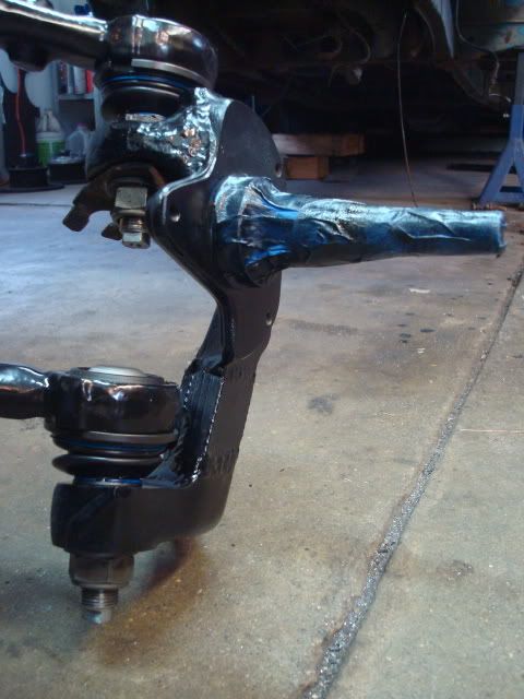

Went with the Oldspeed 2" spindles. They were a little more money than the Wagenswest 2.5" units but I was concerned about the wheel sticking out too much with the .5" that the Wagenswest spindles widen per side. These actually narrow the track a tiny bit.

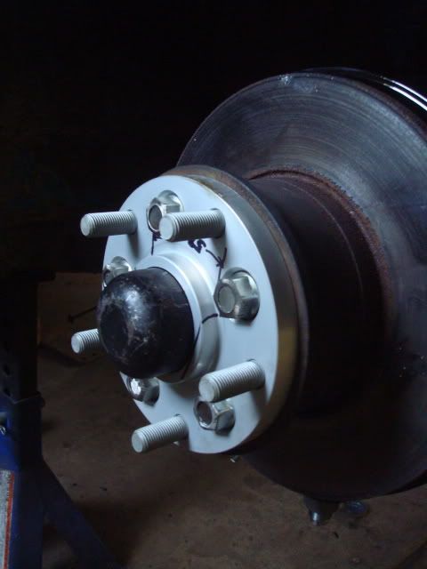

The off the shelf adapters didn't fit over the hubs so a buddy bored them out with a CNC mill. Fits perfectly. Thanks Lans!

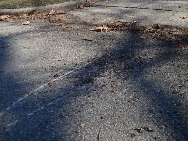

The rear also scrapes the ground a lot. This is my driveway, if you go too slow it will actually stop the bus from moving.
That's from the rear engine mount studs. I'm planning to shorten the whole bar but I'm concerned about what it might scrape on after that (engine case?). I may just end up raising the rear a tad. Then hopefully I can actually have passengers aboard. Also on the chopping block are the ugly heat exchangers and muffler. I'm thinking some nice stainless tucked up out of harms way would look nice.
