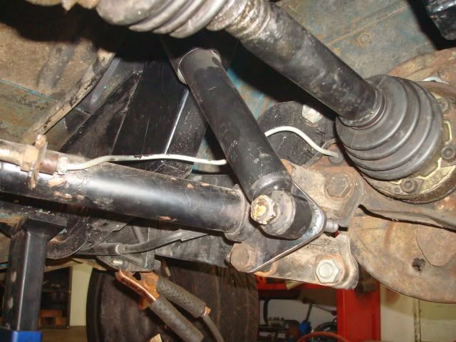

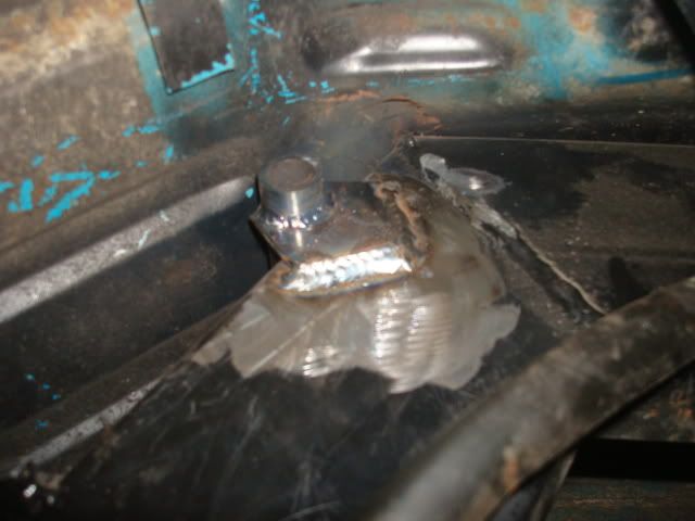

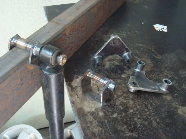

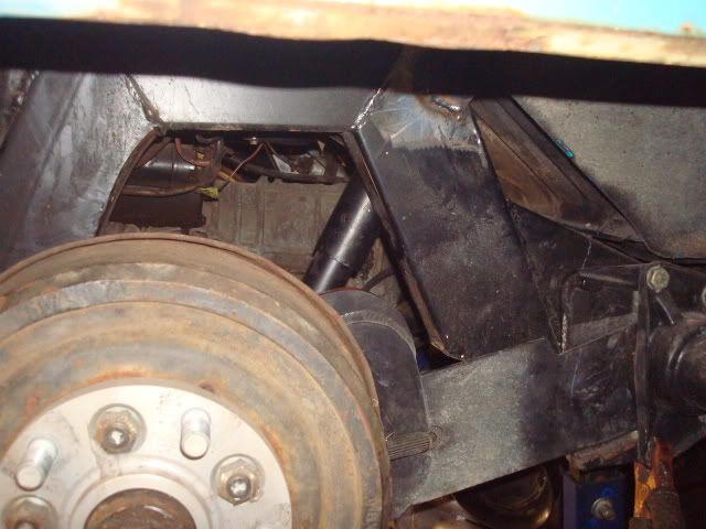

One of the biggest things was the lack of rear shocks. I don't know how people do it without them. I kicked the back end out at highway speeds on multiple occasions just because the rear wheels were bouncing all over the place. The reason I didn't have any in the first place was because with the phatty Porsche wheels out back there was no room for any in the wheel well. So I looked at some options and decided to mount some inside the frame rails.
Started by making some little brackety doodads.
They fit on the bus like so (new hardware is on the way)
The geometry is not ideal but it's the best I can do without going totally crazy. I think it will do the job and hopefully prevent the rear from getting into a bouncing fit that ends with my engine smacking the ground.

Great idea on the shock mount.

I don't know of anyone that does not run rear shocks. Fronts, yes, on narrowed beams. But on my bus, with no rear shocks, the ass bounced all over the flatbed coming home. I have no idea how you drove it with no rear shocks. :-k And your geometry looks fine. The axle moves in an arc anyways. Better than having none, that's for sure!!
