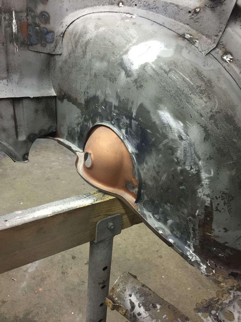

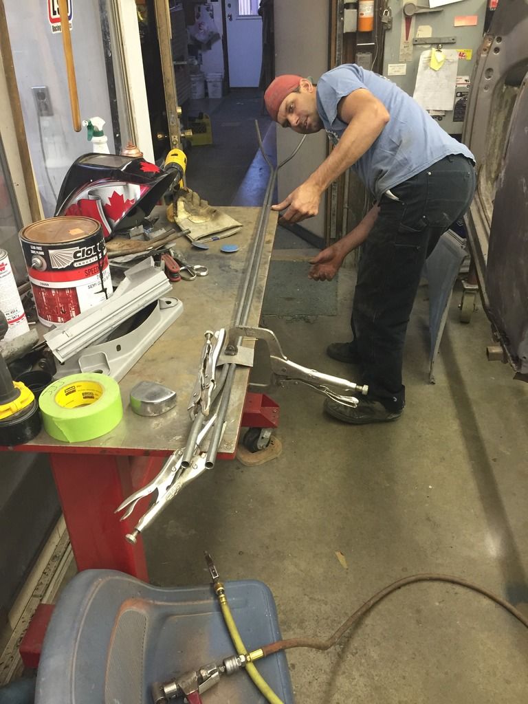

Still plugging away on this one consistently ](*,)
This panel was a whore to make right! Damn mice! After this pic I was able to contour the flange arc better)
Finishing off cable conduits.

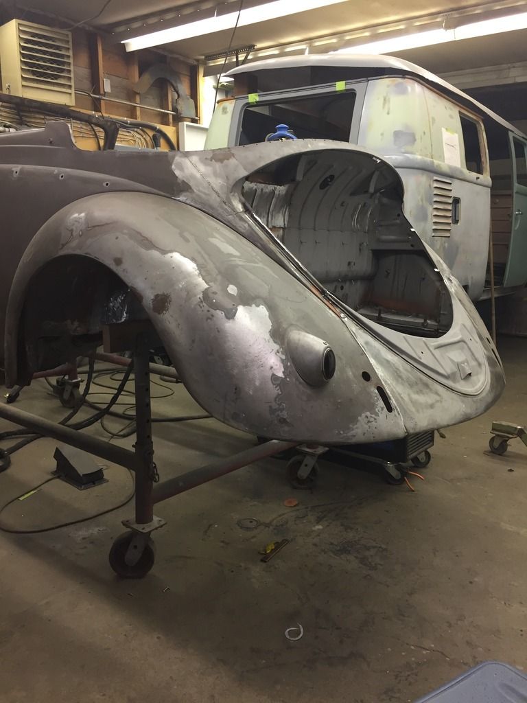

Pat hooked us up with some engine bay shelves that weren't Swiss chez, got one re and re'd lastnight.

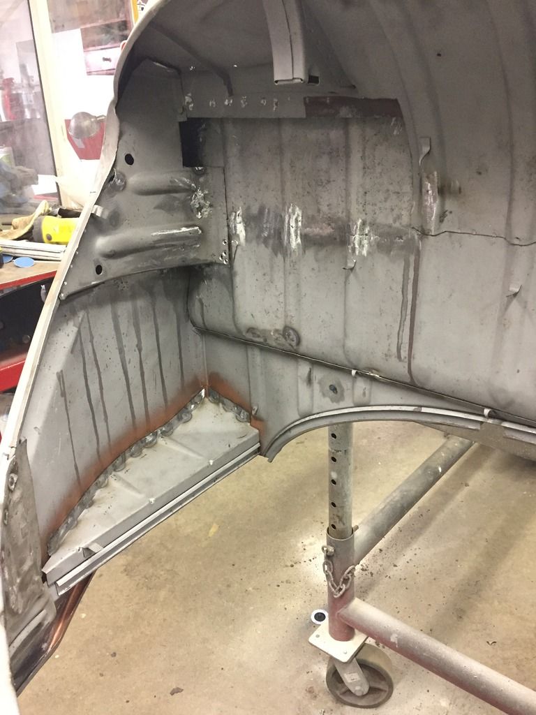

Initially we were trying to patch the rear luggage area with another fucked up section I got from a 54 Canadian custom at the gcvws but it just wasn't gonna be up to par with a 360 butt weld on such a big panel....just dragged home another 55 sedan body to murder and steal this section whole (well half) ..... in case anybody is wondering the stamping back there is pre 55 specific inconveniently enough ](*,)
Cutting the rest out gave me access to metal finish the backside of the rear body mount areas that we fixed but couldn't reach before.

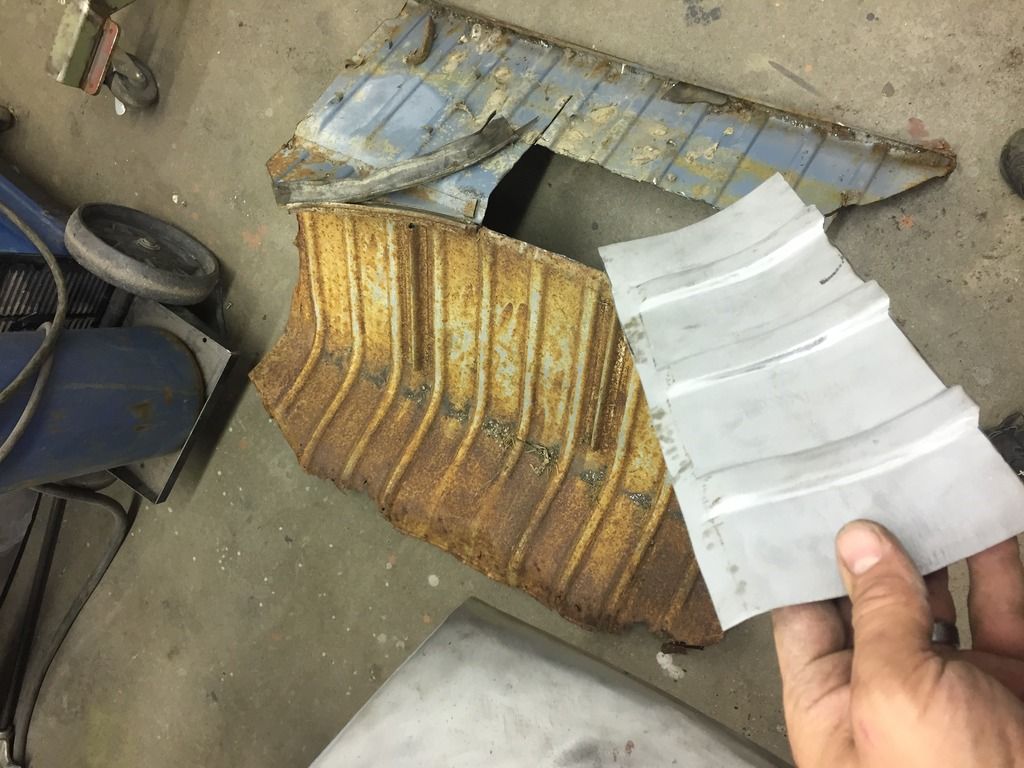

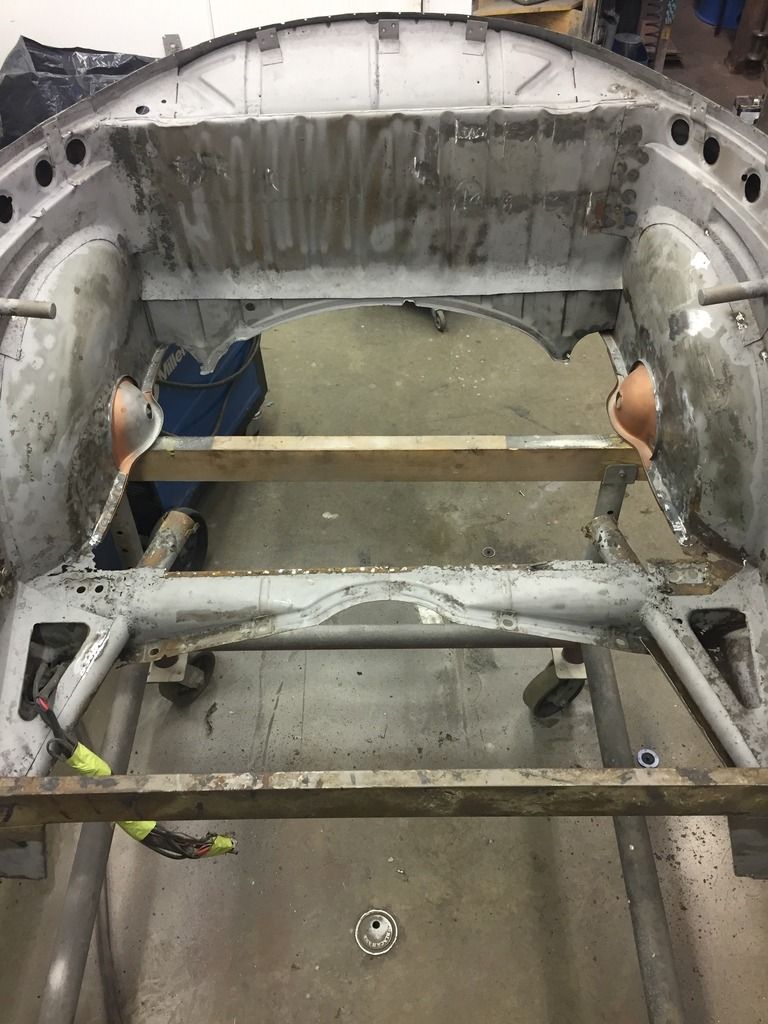

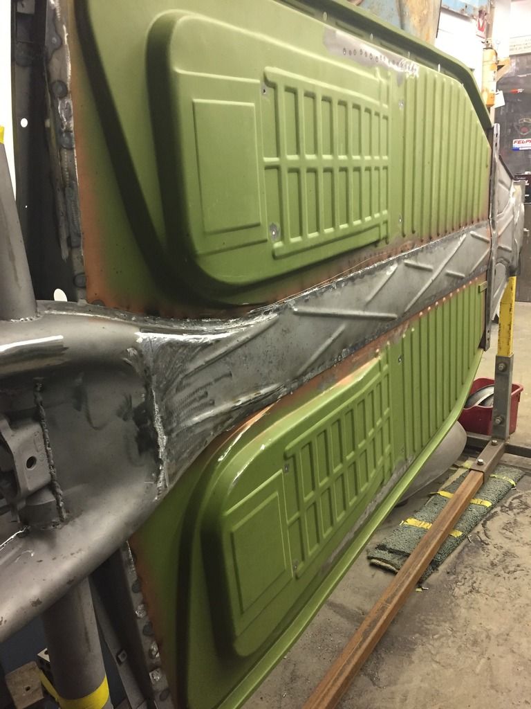

Kickin ass daily....pan is all buttoned up with all new control cable conduits.
So much time has been sunk into making sheetmetal solid in ass end, rear apron got put on for last time last night.
This was fun....taking a flat part of luggage shelf stamping and making it curve without fucking up the ribs!

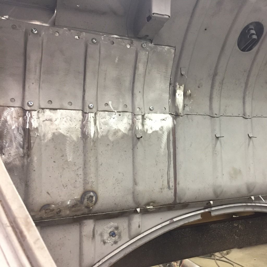

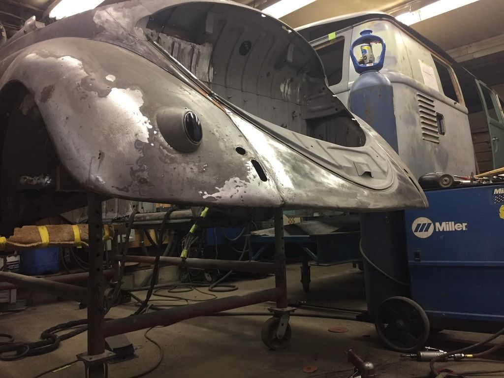

Good work guys. I haven't seen too many bottoms of pans opened up like that...looks super clean now. I'm suspecting a lot of shrinking disc action on the rear apron to get it looking so good.
\:D/ good job on the apron/fender alignment also \:D/ It's the details that make the difference, definitely on the right track
Posts: 4231
Re: Topless 55
Postby jb » Mon Oct 10, 2016 9:58 pm
That apron is from Brian waz in Vancouver....it was ummmm better? Than what came on the car but ya needed a lot of love including one inner. The misery disk was used a bit but the fenders need some yet so will probably get carried away....this thing is gonna be solid =D> Metalwork \:D/ \:D/ \:D/
