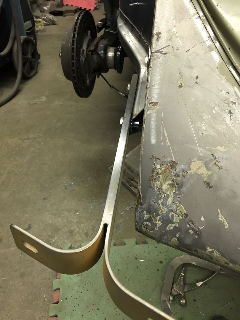

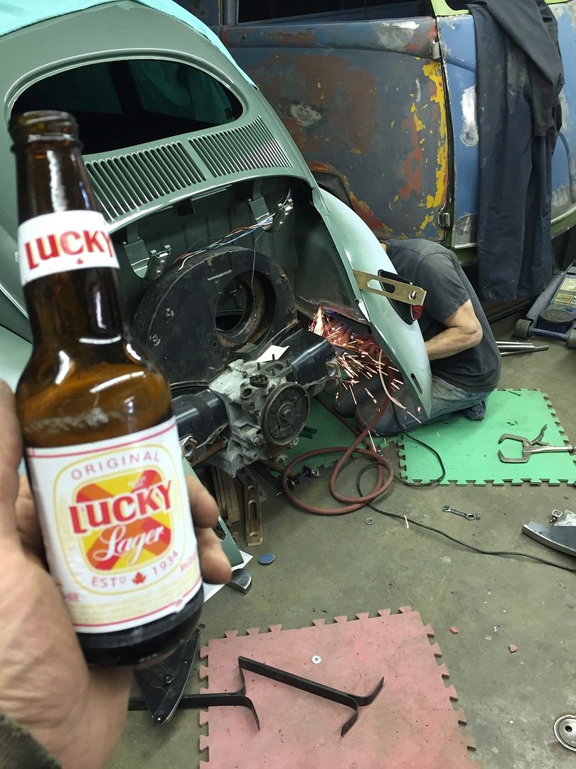

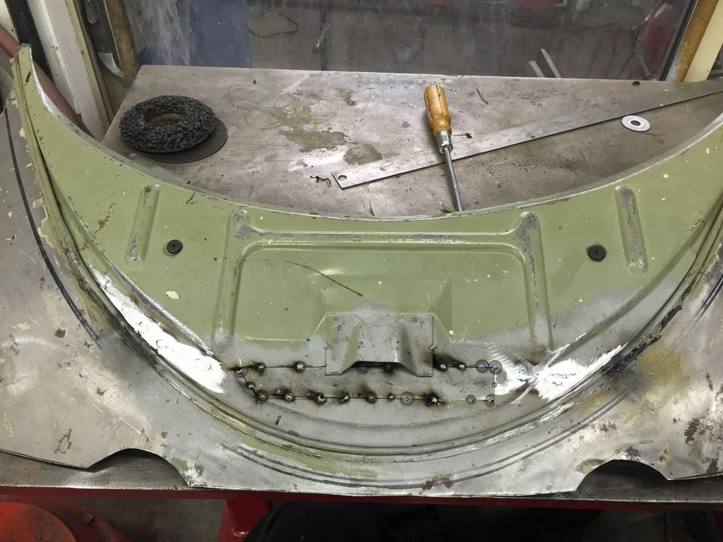

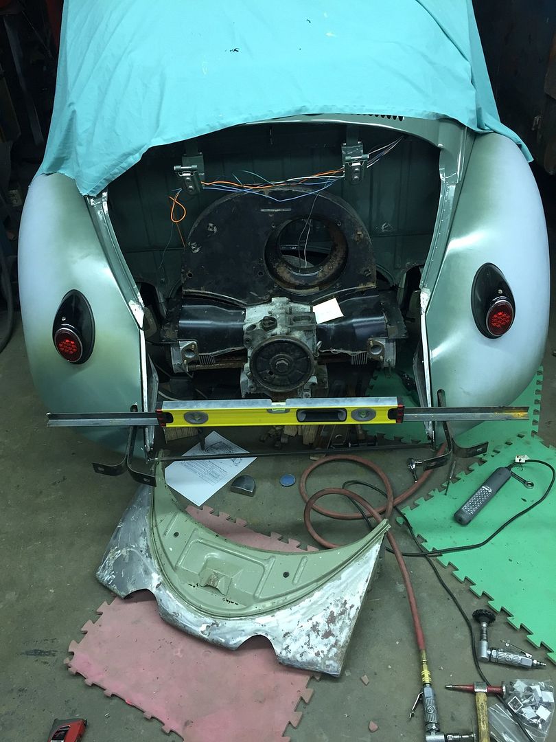

Aftermarket apron and fucked up rear bumper brackets had to go. OG H apron sourced and Wolf rear panels ordered from Sweden. Mocked it all up and levelled bumper brackets, bunch of measuring and burnt in. Apron is pretty neat down but going to be remove able so it's getting cut up. Oh ya and side trays were narrowed by .75" to make room for a wide ass stroker. \:D/ \:D/

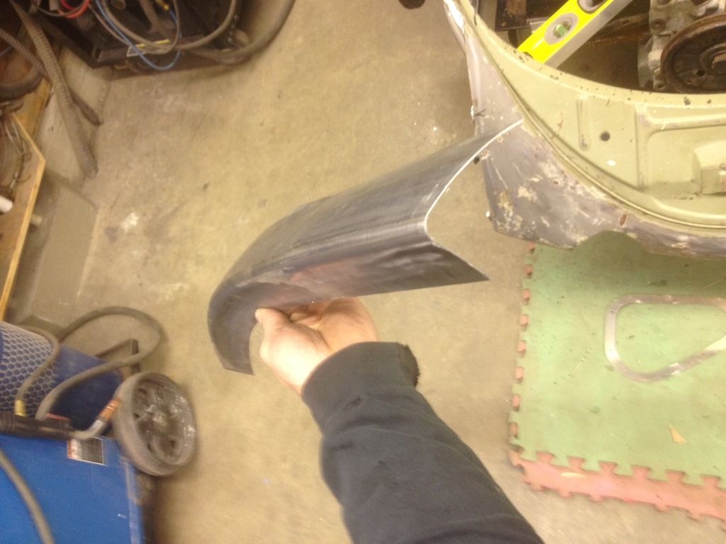

Had these pics from recent texts too...."Webber windows" are happening and playing with the power hammer making a new bottom section for the apron

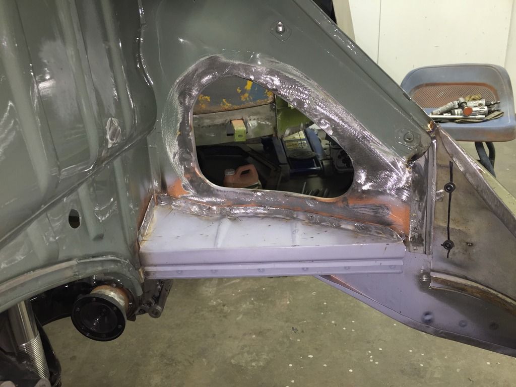

We got the Webber windows all wrapped up....you could fit your hands through to change plugs wearing boxing gloves the panels are so fucking big! It's a rad mod that will make life so damn easy!! 3/16" flange was formed to shape, drilled and tapped for M5 screws and sheet metal hammered over folded into the ID of the flange to finish it off nice....will get edge TIG welded. The covers will house some kind of breathable filter element to double as extra airflow to feed the carbs.
You can see the new Flanges he fabbed to attach the removable apron with 2 M6 bolts =D>

Those are some big access windows. I like the filter material idea.

Looking good. Love the nut plates. Don't you think a filter in those holes is going to collect rocks, dirt, and water?
