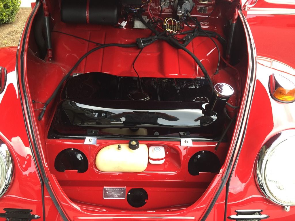

Brett,
it is the one made by Aaron broughton I had already bought the oil cooler and made my own mounts but liked his much better.
so I asked him about buying the brackets just themselves.
it really is a nice design

^^Yeah if be interested in details on this unit too. Thermostat included and what temp? Wires, hoses, fittings too?
Posts: 708
Re: Russ' 65
Postby russ scott » Thu Mar 17, 2016 9:34 am
it's just a normal setrab oil cooler http://www.setrabusa.com/products/fanpa ... index.html
the brackets Aaron made are slick
as for thermostat I bought a 190 degree one and it -8 bungs that screw in to the oil cooler
it's pretty simple once mounted just run your oil lines and you are good to go
to answer your question Aaron set-up is just the brackets, hardware and oil cooler, you will need to supply your own AN fittings from oil cooler,thermostat and oil lines

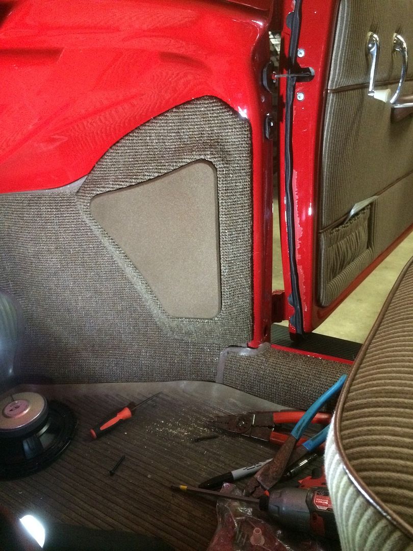

Russ it looks like you carpeted the speaker panel separate from your inside quarter panel. Thats a clean look. How are your speaker panels attached to the quarter panel?
Posts: 708
Re: Russ' 65
Postby russ scott » Mon Mar 21, 2016 3:33 pm

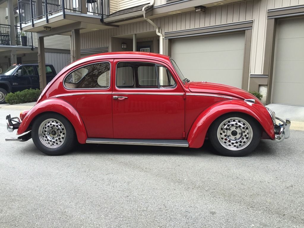

got the alignment dialed in and took it for a rip, pretty happy with how it is turning out. I have just a few smaller things to do on the interior then when I get a chance the engine will go in
I have a few paint touch ups to do as well (the inside of the one door ect)
all in all not a killer show car but I'm pretty happy so far

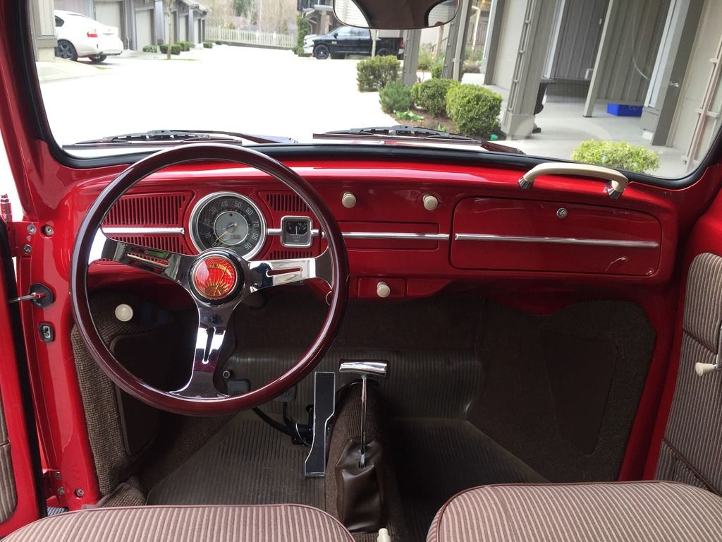

the car looks fan-bloody-tastic man! Really like that shot of the dash, give me something to aim for.
