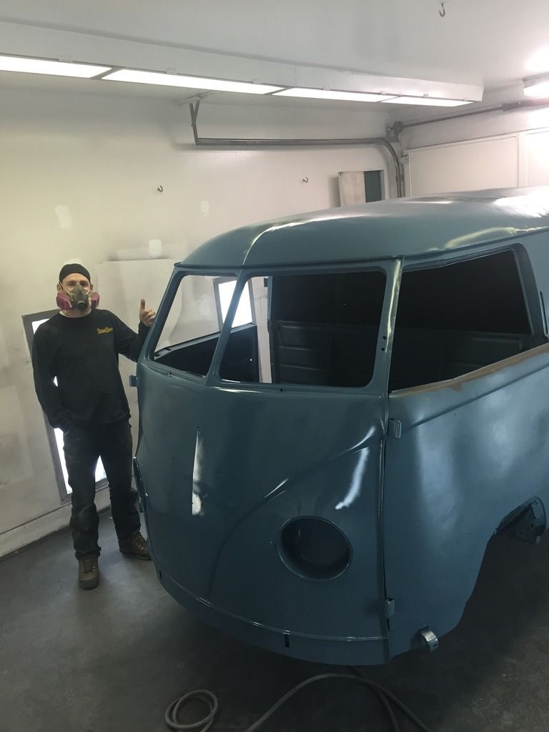

Postby jb » Fri Mar 10, 2017 9:53 am
This ol girl is mostly blue again! We had some help spraying from Johnny's buddy russ \:D/
Won't be calling it an og pint bus but plan is to rub back some of the new L31 into what was left of the old and fake a bit of funk Wink
Super stoked on the paint match, Jrod made 101 trips to paint store for ](*,)
Its assembly time MUTHAFUCKAS!!! =D> Kelly park here we come!!

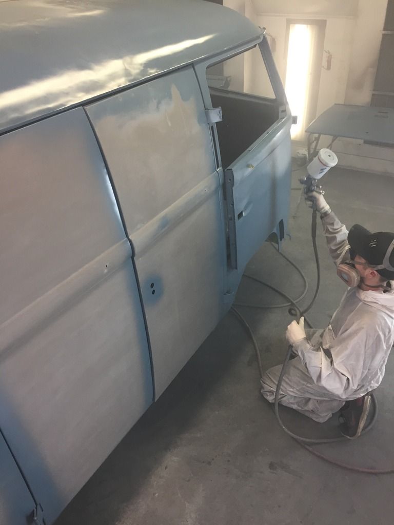

Looks great, but dumb ass question. Why are there two holes in the drivers door? Can't think of any reason for them. :-k
Re: "Scarface" 54 BD panel build
Postby jb » Sat Mar 11, 2017 7:33 am
BBWB wrote:Looks great, but dumb ass question. Why are there two holes in the drivers door? Can't think of any reason for them. :-k
Gas pedal goes through floor unlike later buses
Ain't no kcw pace but we tryin! \:D/

Not driver's floor. Smile About four pictures up, driver's door. Has two little holes.
Postby jb » Sat Mar 11, 2017 10:32 am
Oh those holes......door/floor same shit at 2am right? 8-[ at one point looks like there was a sign screwed to it....Johnny wanted them left :-"
Posts: 1945
Postby BBWB » Sat Mar 11, 2017 11:18 am
Haha. Yea, I don't do 2am shit anymore. Wink To old, like my sleep.
Holes make sense now.

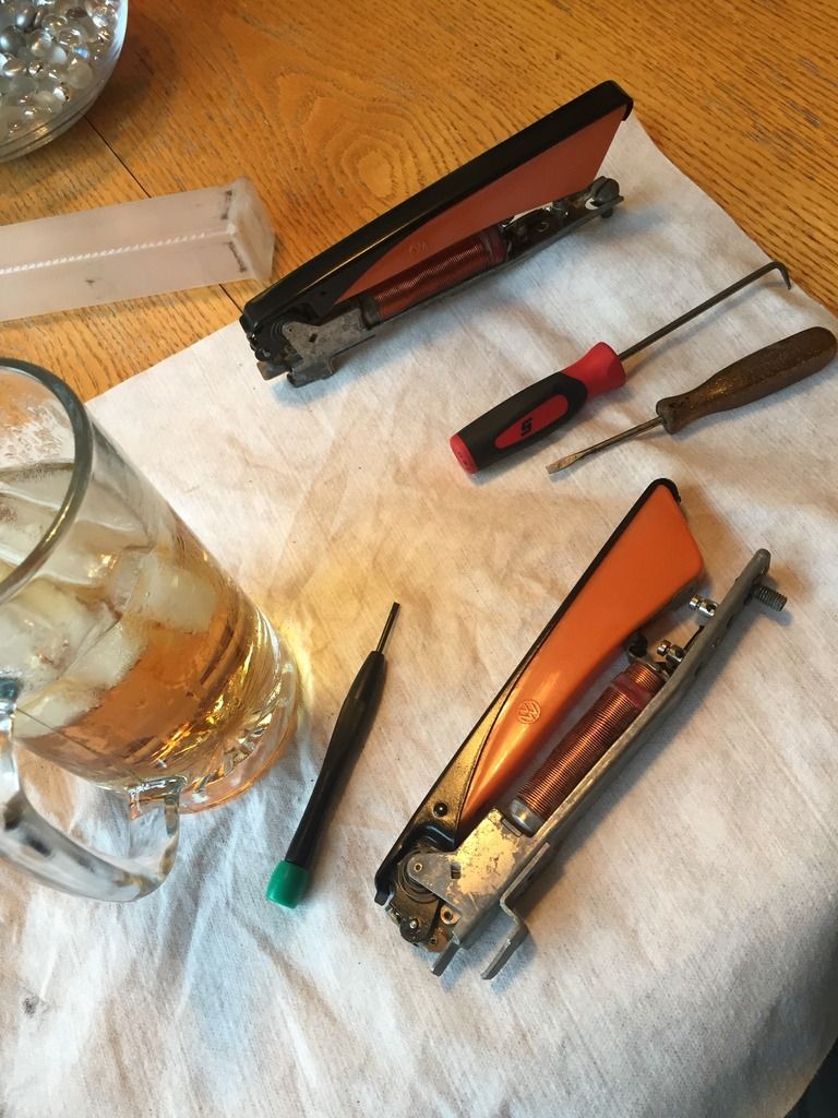

Quick fluff'n'buff on what have got to be the nicest original semaphores I have ever touched! All they needed was an ultrasonic bath, some fresh black paint on the arms and one new bulb wire. Redo the cloth wrap and some new stickers they will look NOS Wink

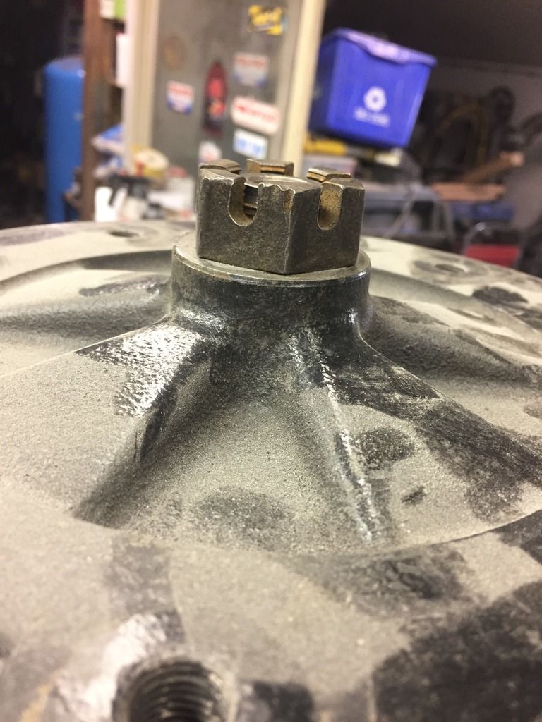

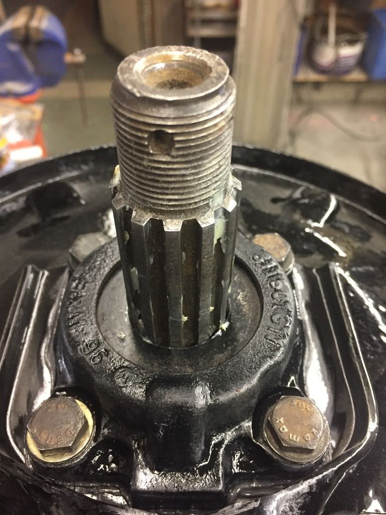

Worked on sealing up the trans lastnight...68 swing with a 3.88, short axles/tubes and type3 rear brakes.
Ran into a little issue......
Who is the T3 brake guru? These came off a buddy's 57 single with hybrid axle tube/endcastings and long axle combo. Everything looked good bolting up but when went to throw a drum on the holes were hidden for cotter pins.
The seal caps are type 3 I believe, they have the casting that wraps around the seal and doesn't let the seal spacer/hardened washer come out without removing the caps. The spacers are the tall ones I think.
Question is what has to happen here? Different seal caps/spacers? Or machine snouts of drums 1/4"??

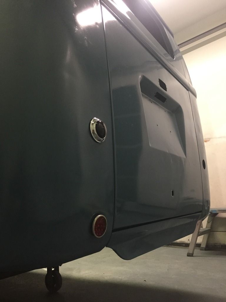

Got doors adjusted and decklid on to finish the evening off \:D/
Oh ya had so see some silver white on there too!
