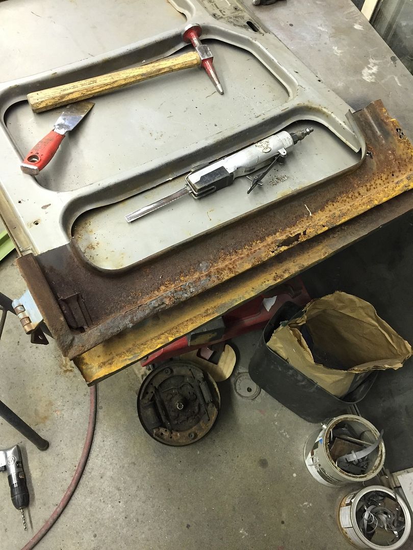

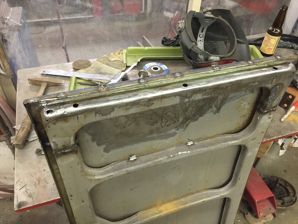

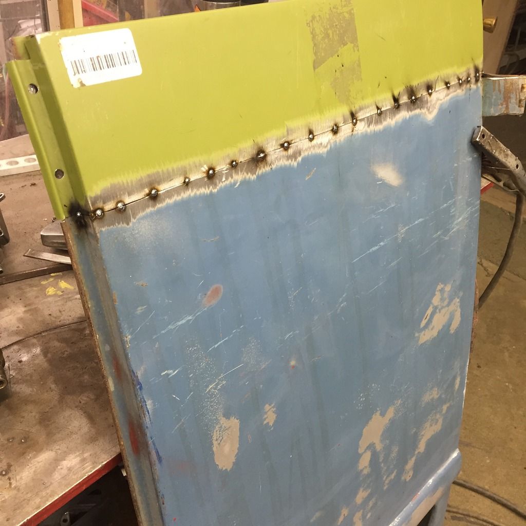

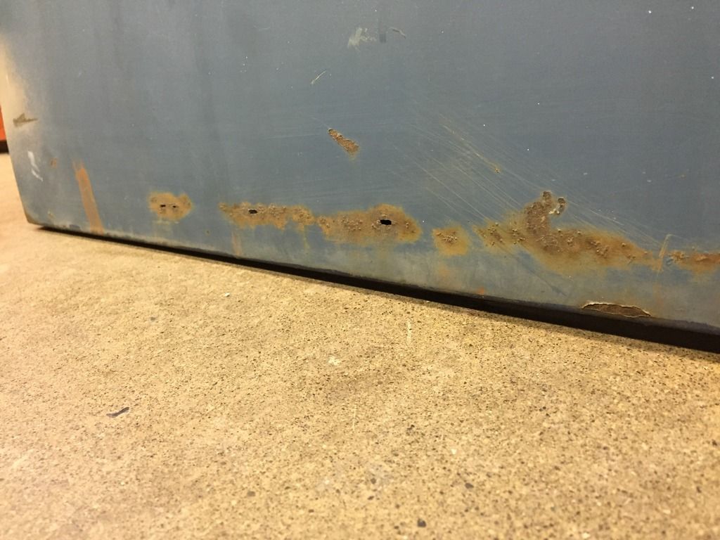

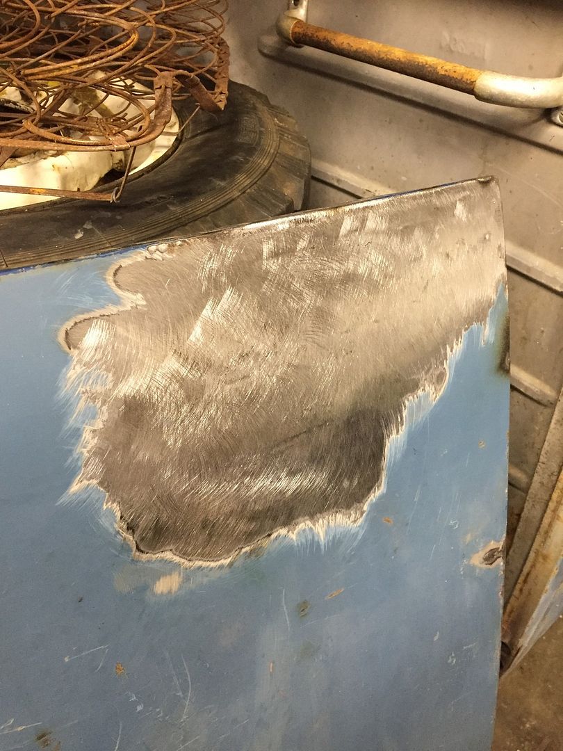

I spent last night tearing into my cargo doors...forward one had a big munch in it and a rusty inner bottom, rear just a rusty inner and a couple pinholes in the skin. I attacked the front one, cut out inner for access for shrinking the skin. Some time with my fav tool the shrinking disk and it's looking way better!
Pic doesn't show it but the rusty spot here was stretched out like your favorite pornstar :-s

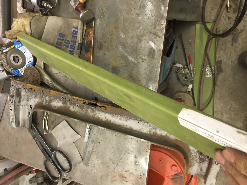

Recycled a funky green cutoff of barndoor nose skin to fab up a new seal channel.

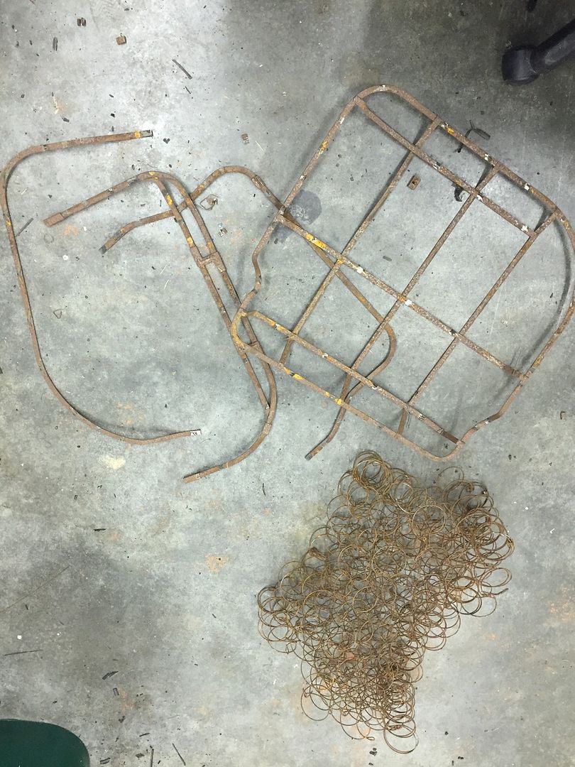

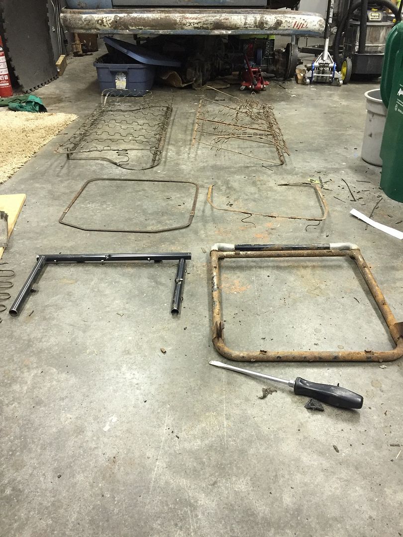

Gary busted me on IG diving into my seat frames....cut up a late model rear bug seat for donor springs and frame patches. Flipper section of the middle seat had worst frame rot.
Lowlight scraps
Like I needed more shit to turn into sugar the trade on my front seat was waiting on the door step when I got off work =D>
Gonna need some love but totally workable and correct for the bus!!! =D>
One cargo door done

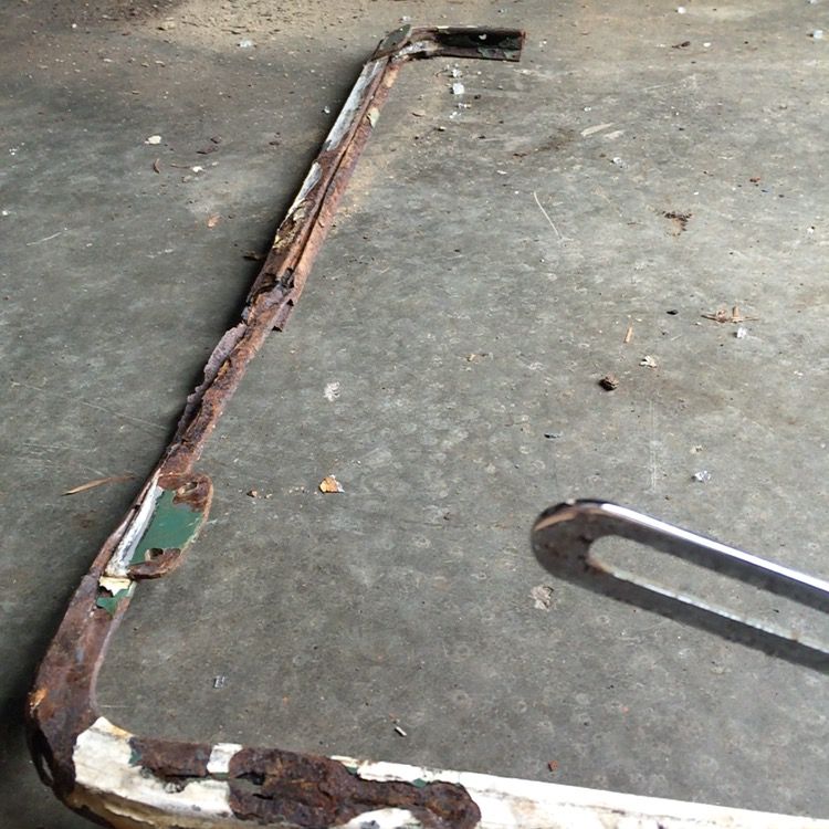

The Aft one is worse...gonna have to do the outer skin too. When we found the bus it had yellow Fiberglas house insulation packed in all the voids, held lots of funk in there ](*,)

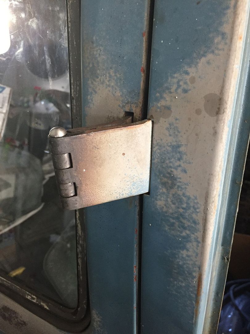

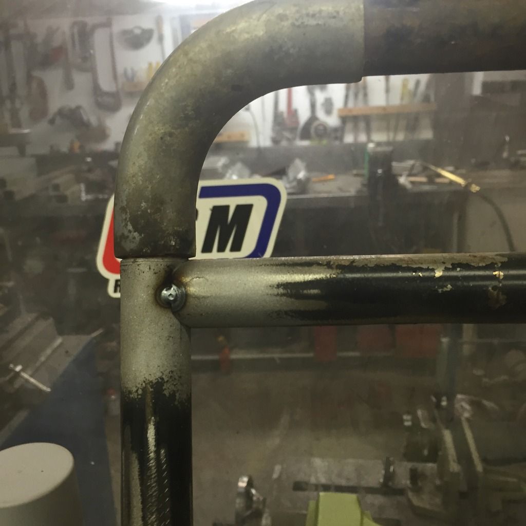

Spun up some oversize cargo door pins today on my lunch hour Wink factory is 6mm, I cut the heads off OG ones after I centre drilled them on the lathe. used .250" drill rod and knurled them then step cut the ends to fit into and centre the mushroom heads, will zap a tack on the ends and buff off....will look og :-"

Reamed jalopy hinges oversize to .250" (something like .020" over) and drove in my new pins....ready for another 1000000 openings
Both cargos are 100% done now.

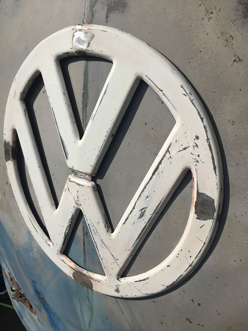

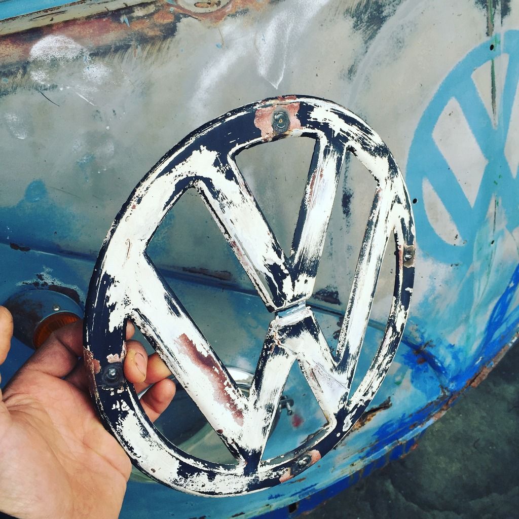

Paint stripped my OG emblem, 3 layers of paint later and found the silver white and little L31 stripe detail Wink

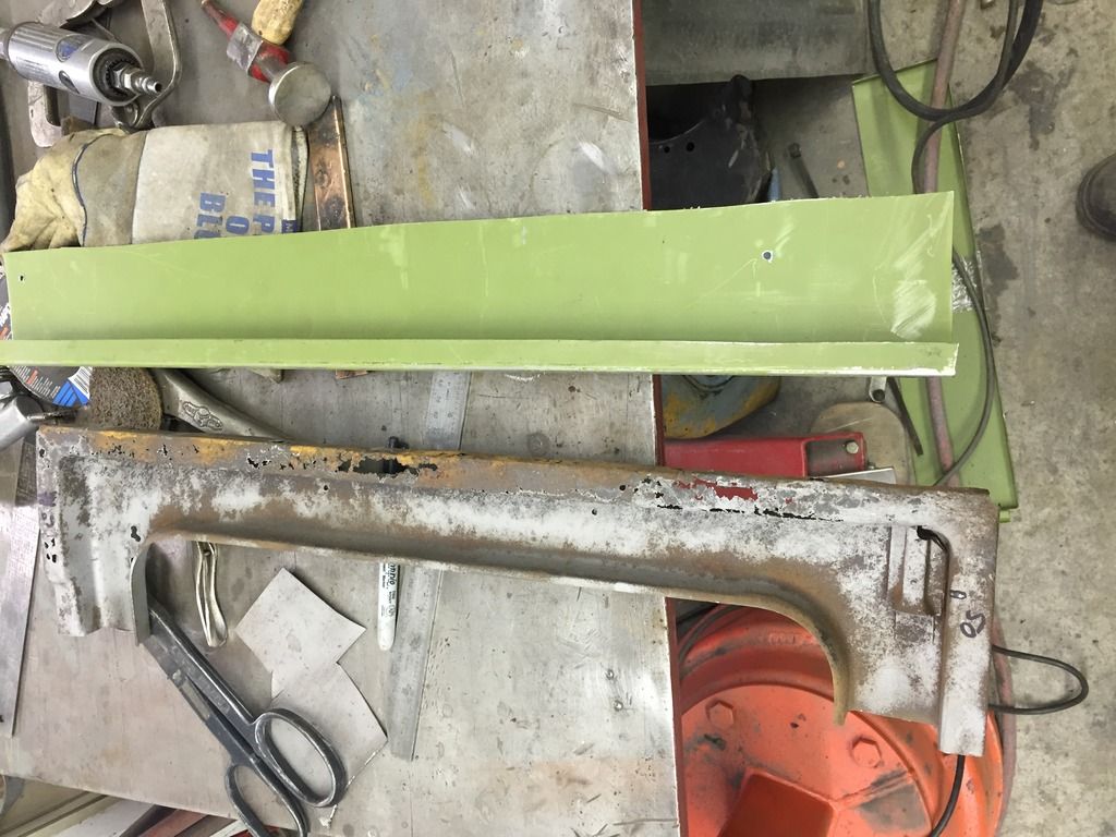

I wish I could afford all the metal I need for this project....instead I'll focus on all the goodies. Thinking its time I attacked some safari repairs.... :-&
The way these were made originally is bizarre! Thinking I'm gonna have to make some sort of press die/jig to form repair sections?

not much left of them, or the seats
it's a good thing your damn talented lol, keep up the progress man
