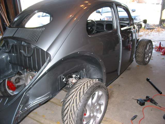

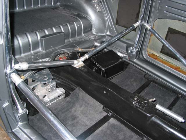

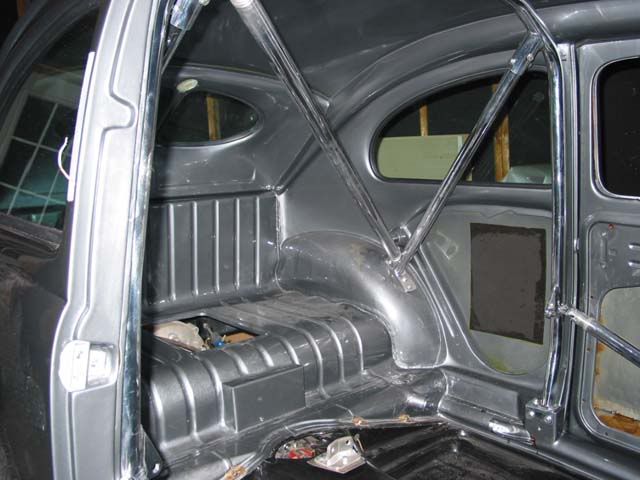

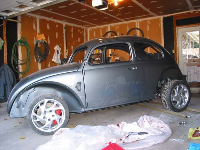

Coilovers front/rear, Porsche 993 Turbo brakes, 944 arms, Thing beam, Hiego cage. Bolted to NOS IRS pan.
Wheels are Boxster. 1yr only, special order. Not really feeling them. Your thoughts?

The wheels are a bit busy... Car looks awesome though!

I would agree! We're you planning on finishing then other than the stock finish?
Please tell me no Fuchs tho [-o<
Engine plans?

Yeah!!!! Some cool ass shit on that rig! That cage is a trip...thing is gonna be a cornering machine! In my opinion it does need a wheel swap but hard to tell with no fenders? Some cups or old school BBS honeycombs?
What's it getting for a motor?
Bad ass autobahn machine dude! \:D/

I'm about to do the poor person version of this to my early '55 ragtop, for better handling and to use all my 944 stuff. Did you modify the body mounts for the later pan or modify the pan to work with the body?

Bbs rs wheels are needed

Yeah, I think you need some $5k+ wheels for a build like that.

The body had mounting brackets installed in the rear wheelwells.
Engine plans were a 2276. But that motor ended up in the bus. So a EFI 2332turbo is planned to be stuffed into this.
No Fuchs!!!
In my stash are 18" BBS LM's, and looking at refinishing a set of 17" BBS e26's as the final wheel choices.

I vote e26s because they're super sweet but still have a little depth to them. Those and the LMs are about my favorite wheels so maybe I'll just sell everything I own and be ready to buy your car when you're finished, haha
