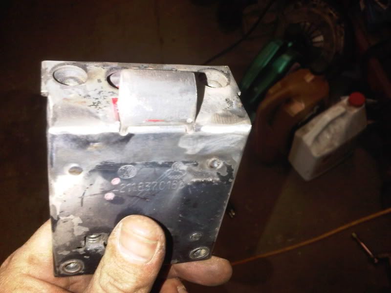

Postby Glock » Wed Apr 11, 2012 8:16 pm
Ok. So actually made some real progress today. Along with more shitty cell phone pics!
Got the front end up on stands.Set the penetrating oil on all associated brake parts that need attention.
Dropped the front pan and stripped it and coated the inside. Outside gets finished tomorrow.
Figured out why my pass side door won't open ... The cracks allow the mechanism to flex instead of move the striker.
Did a little welding (thanks Ron) and some grinding and now I can open my pass door from the outside. This was very exciting. It's not quite up to gonebuggy standards but no one will ever see it.....
