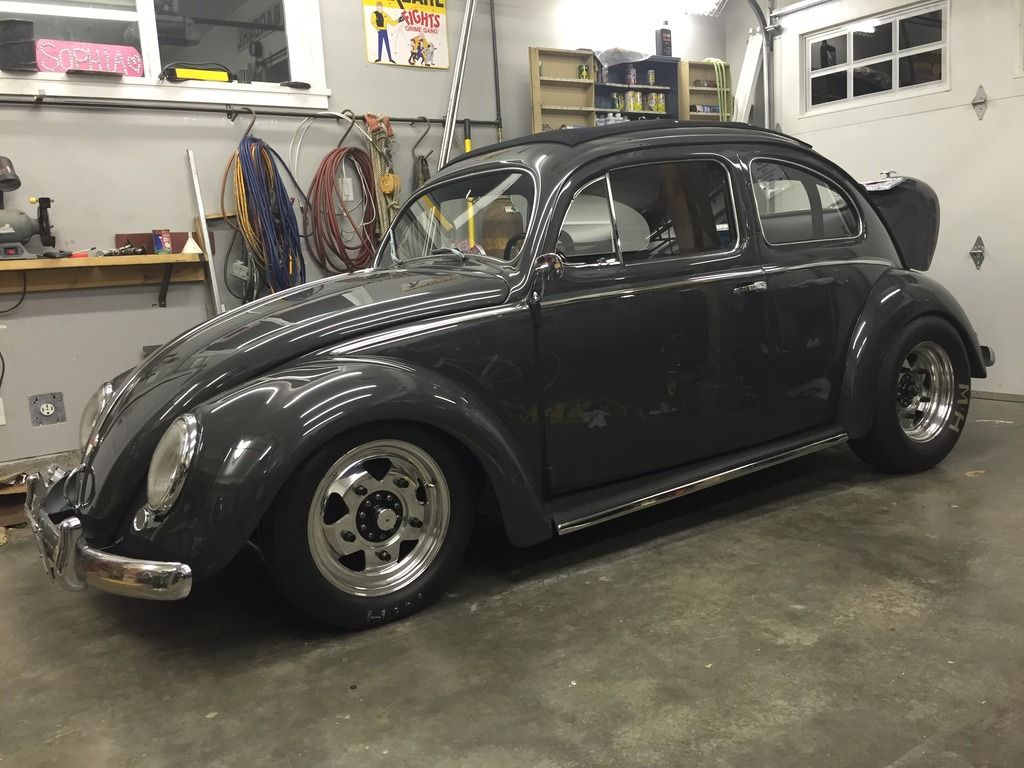

That angle of shot makes it look stock height :-& .......this ones a bit better :-$

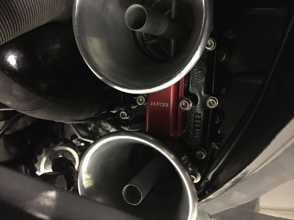

Fixed my bent throttle shaft tonight. Was super straight forward repair. I don't know how it happened yet, guessing had the throttle cable too tight? One of the butterflies was leading the other by I don't know .015"? It was uncovering the progression holes just a little before the other. You could see it on the sync tool between the 2 cylinders on that carb. Broke it down then put the butterflies back in the shaft....you could hold it up and eyeball the blades then carefully twist the shaft gripping the flats of threads with 2 crescent wrenches. Used a flat edge and a flashlight to fine tune. All back together and reinstalled.

Rad dude! That thing looks anything but stock height, and mean as hell from all angles!! I'm surprised you didn't knife edge the butterflies when they were out.. Wink \:D/ \:D/

bet he polished them.
