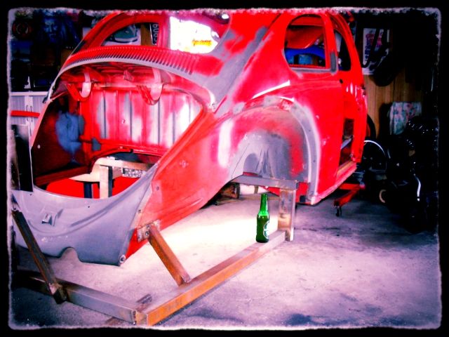

Postby 63Ragtop » Sun Sep 06, 2015 6:37 pm
I'm new here, but I've been lurking for years.
I got a lots of good ideas from this thread so i thought I'd show you my rotissery.
The problem I had is that my shed is only about 7foot tall, most on here look about 8-9 feet tall.
So this is how i worked around that.
Starting with one really old engine stand and one really cheap china one.
I Drew up a cunning plan.
welded this together for the front end after I extended the height of the pivot.
and this thing for the rear once I fixed the rust and suck new wheels on it.
added these braces to the rear bumper mounts.
so far so good!
welded in a few cross braces as I don't really trust my welding that much!
yeah.

Cheers guys, I dunno about nice, but it has gotten the job done, damned if I was going to lay on my back drilling out eleventy billion spot welds on the heater channels!
I should really have widened the cheap red stands base, it's a little narrow. I make sure the kids stay well away from it.
