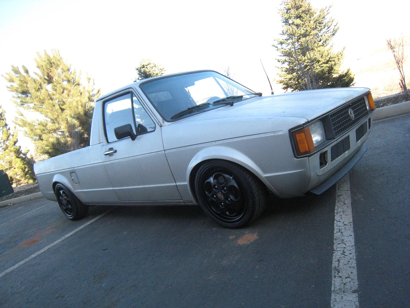

Awesome John! You'll be ridin dirty soon enough!
So here's what I did if it helps at all.
Front:

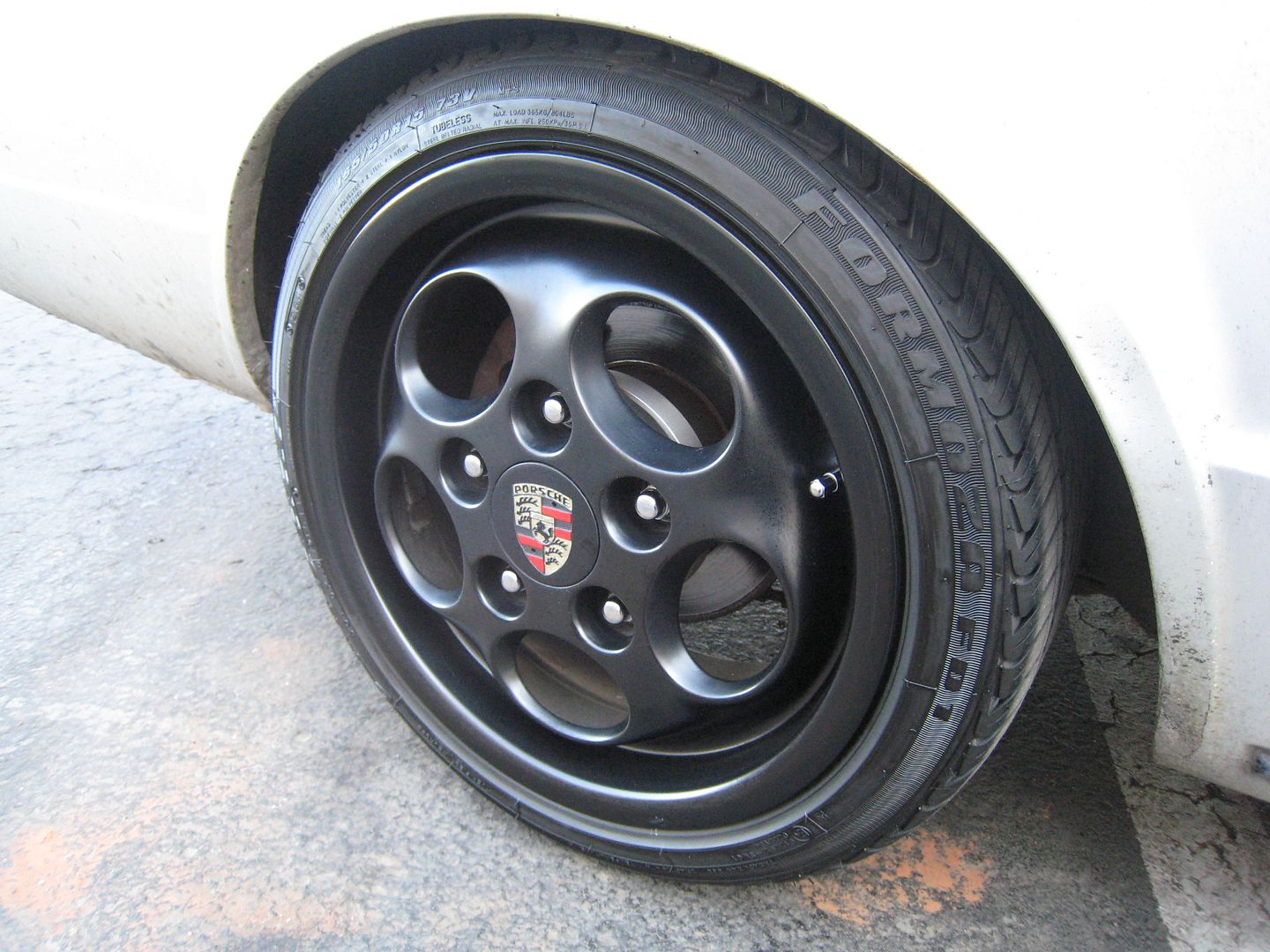

-Raceland coilovers
-Travel extending deep upper strut mounts (as seen in the photo) The coilovers wouldn't go low enough and still have any available travel.
-15x6 et52.3 Phonedials with 165-45-15
-C-Notched the unibody for the axles. I think I only had to do one side though...
-1" thick 4x100 to 5x130 wheel spacer/adapters
Rear:
-Axle flipped above the leaf springs
-Rear leaf spring shackles shortened (this got the rear a bit lower)
-Stock shocks still worked if I remember correctly.
-15x7 et52.3 Phonedials with 165-50-15
KCW Internship Graduate #1
Matt Faulkner
Location: Denver, CO
Re: KCW Kaddy
Postby Matt Faulkner » Tue Jul 14, 2015 7:59 am
I did not flip the tie rods or extend the lower ball joints. It would be proper to do so, and the bump steer was crazy, but the raceland front springs were stiff enough to limit travel enough where I never noticed any ill effects while driving.
