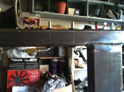

Next thing I did was attack the floor and firewall. I chanelled the body 4" over the frame to hide the frame rails. I tacked some 2X4 box to the underside of the frame rails and set the body over the frame to start the sub floor. The subfloor is 1X2 and 1X1 with 6 mounting holes (with tubing welded through). The drive shaft tunnel is angled because the axle pinion is not centered. Should have bead rolled the floor panels. Oh well, live and learn.
I was a stickler about the wheelbase because I do not like mile long rods. Seems like that would hinder performance (handling) and that ain't what rodding is about, IMO. As a result, I wound up recessing the firewall 4" on top of the 6" I had previously cut off for a total of 10" of engine set-back. I had to make the dizzy cut out quite a bit wider than in these pics. Starting to have a 50's drag car vibe.

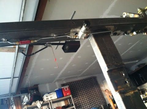

In pic 3, you can see the cheese dick pedal linkage and the finished column drop.

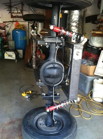

Previously, I had purchased a torch head, regs., and hoses from craigslist. I forked out some cash for oxy and acetylene bottles (whatever size is the next down from Q). I had an issue with drag link clearance and the lower water neck of the radiator. I heated and dropped the spindle steering arms (same age-old mod as used for tie rod/wishbone clearance when running a dropped axle), cleaned them up, and took them to work for magnaflux check. After I got the green light from NDT, I pressed in new king pin bushings and honed them to fit the new king pins. With the refurbed spindles installed, I installed new shoes, springs, and seals from Bob Drake Reproductions. Wheel cylinders and soft lines are Speedway units and wheel bearings are repacked O.G. 40 Ford running in O.G. drums, unturned. Luckily the drums were in decent shape.
Out back, I pulled the center section and axles. Installed new axle seals and rehabbed the brakes with off the shelf cylinders, shoes, springs, and deleted the e-brake (for now). The center section had a going through in the process of installing a JEGS chromoly mini-spool. I kept the 3.25 r&p for the time being and set pinion bearing preload with a new crush collar (will replace with Richmond 3.7 gears and solid pinion spacers this spring). Also set backlash and carrier bearing preload at that time.

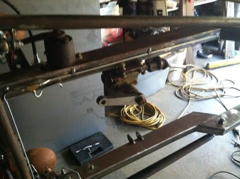

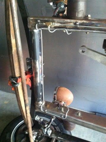

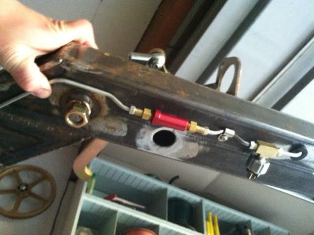

Master cylinder and pedal assy. are Speedway units. The pedal assy. was designed for the inside of the frame rail. I had to disect it and weld it back together backwards to fit on the outside of frame rail. Hardlines are a 25ft. roll of 3/16" brake line and a bag of tube nuts (had to buy 2 different tube benders and a flaring tool). Other items of interest: Wilwood residual valves, Wilwood proportioning valve, in-line T with brake light switch.
