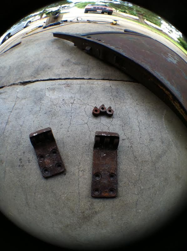

First order of business was lose the existing floor, free the door hinges (rusted shut) and just clean it up in general. Half of the hinges had to be cannibalized from a spare cowl. The others would NOT come out of the body and had to be weld repaired. Don't have a good pic of that. Evil evil hinges. I think I spent a full week on hinges alone.

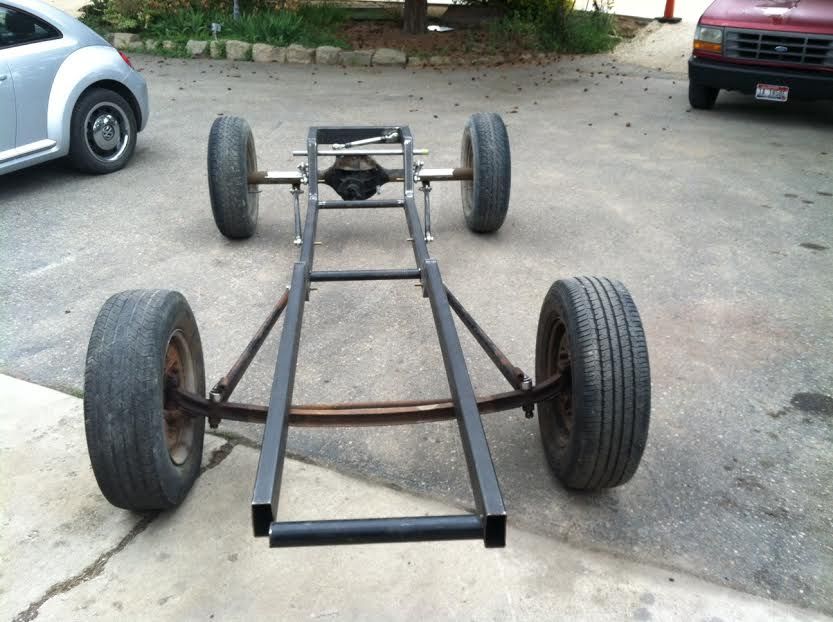

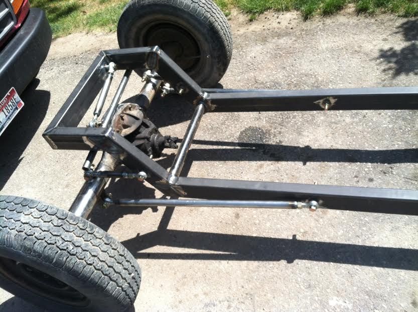

After that, I acquired a 9" rear axle and "runner" SBC 350 from craigslist and started on the frame. I bought a stick of 2X4X.12 wall tube, found a level spot on the garage floor and built the rear kick-up. Kind of just winging it on most of my dimensions. Don't remember why I made the lower bars so long #-o Probably because I didn't understand 4-link suspension geometry at that point and just thought it looked cool :-& . Just one of many things that were done 2, 3, or more times to get it the way I wanted.

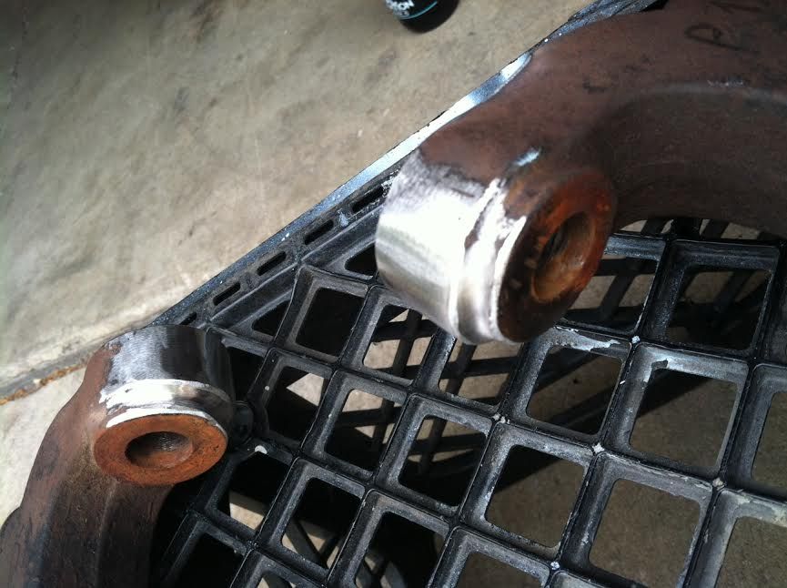

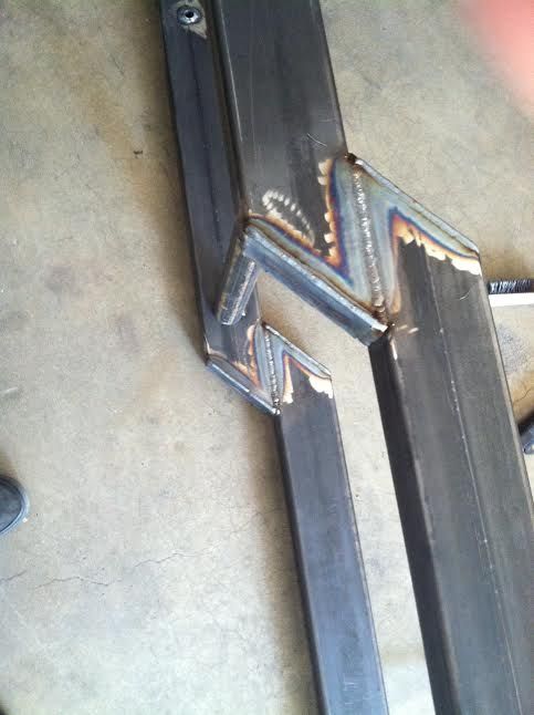

Then, split the wishbone and step the front of frame. Again, a lot of guesstimation happening at this point. I added some temp. x members, then cut and stacked the frame rails in the front and made plate gussets for all weld joints on the frame. The wishbone originally had the spring in front of the axle. I cut off the horns that the shackles mounted to, reshaped the ends of the bones, and turned the sway bar mounts/perch pins 90* for a spring over axle front end. shackles are trailer units and rod ends are from heavy duty CAT top links bought from the local farm store.

I determined the position of the front step by taking a measurement from rear axle position in the rear wheel well to the front of the cowl, then subtracted 6" (I planned to shorten the cowl). The front frame rails were intentionally left long. I then set the front axle under the frame 105" from rear axle and marked where to cut the front frame rails and mounting position of bones. Anywhere a bolt goes through the frame, I welded in a steel sleeve.
I cut the front rails where I marked them and started to brainstorm the front crossmember. I didn't want box tubing up front, So I used a 2 3/8" O.D. .19 wall tube. I got that welded in, and then made long pie cuts to taper the front of the rails from 4" down to 2 3/8". I left the top and bottom pieces of the box tubing long to wrap around the front of the cross member
I ground the welds a little but not completely smooth. I don't like to grind too much on a weld that is structural.

Some more chassis pics. At this point, I still hadn't shortened the rear lower bars, nor had I redone the axle mounting brackets for the shocks and four bars, otherwise the suspension was done. Sort of.
