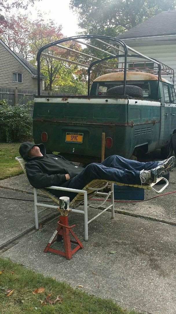

Had some time to spend on the DC while the kids were out Trick or treating. I got the inner rocker and front out rigger installed. Then I finished burning in the B pilar. I was also able to finish up the C pilar behind the cargo door.
I was also able to get some serious relaxing done and spent two nights in my camper Friday and Saturday.

Nice cup holder. Smile
Image[/quote]
NICE!!!!!
Posts: 20244
Re: 5/66 Double cab
Postby Franz » Tue Nov 01, 2016 7:16 am
Is that a custom chair?
Re: 5/66 Double cab
Postby Glenn A » Tue Nov 01, 2016 7:53 am
Franz wrote:Is that a custom chair?
That was the most comfy chair I've sat in in a while. Vintage stuff aluminum pipe frame, perfectly balanced. My homeboy bought the house and it came furnished with the OG owners stuff.

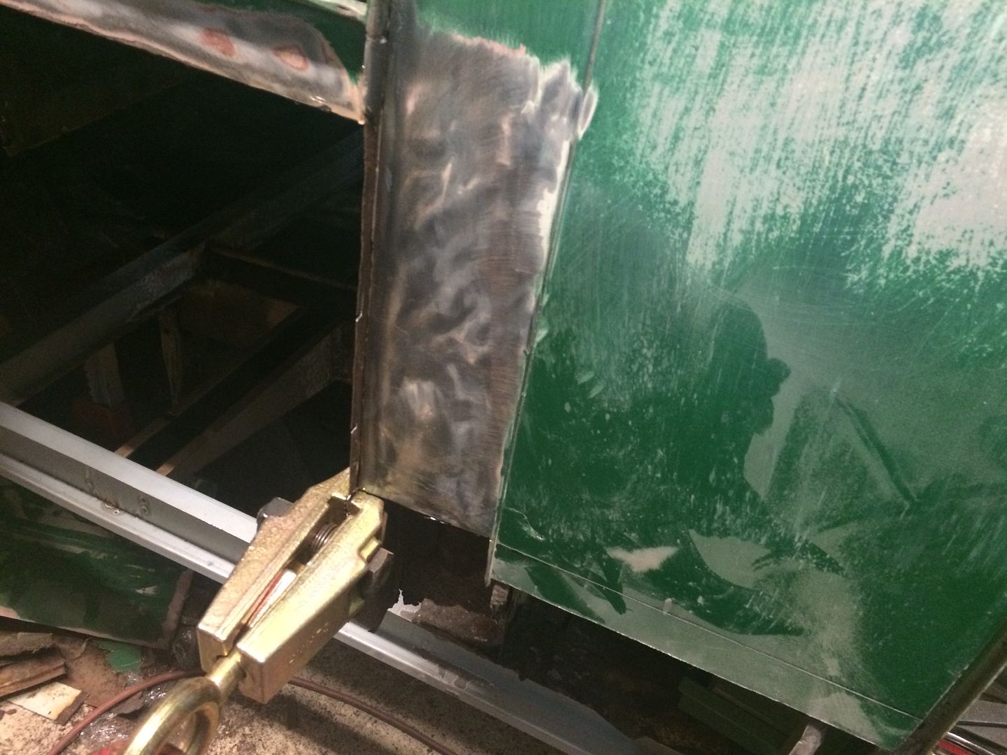

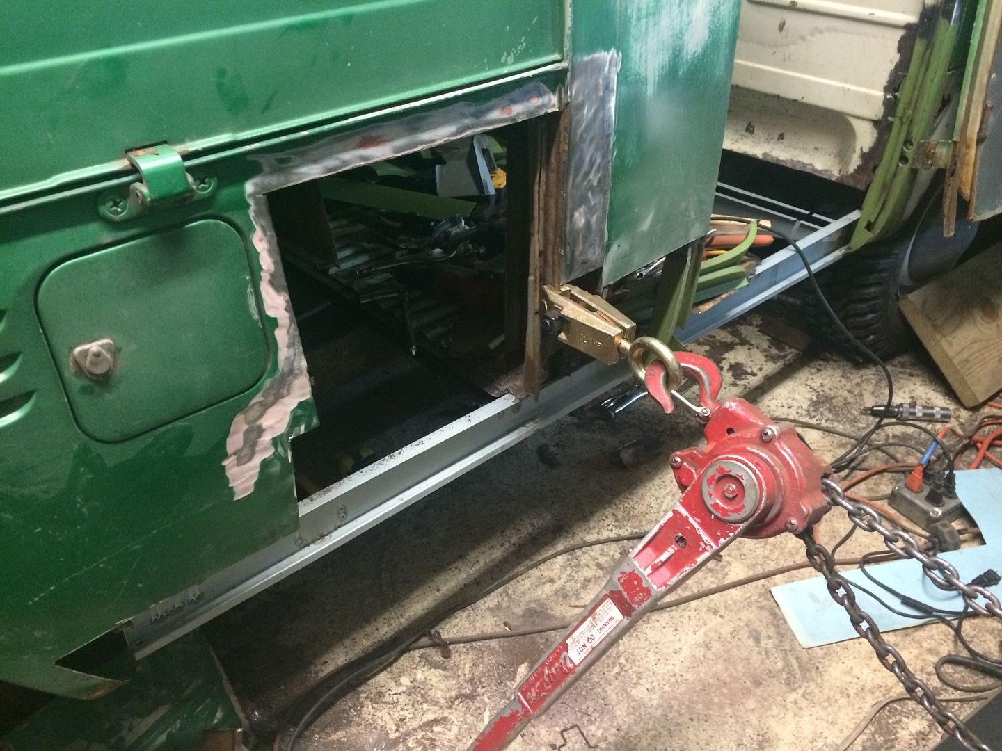

This DC got slammed in the side at some point. I'm guessing it's the reason it was painted. I got the pillar pulled. The quarter skin was toast as was the middle pillar that all got cut out. I got the rockers behind the door mostly fitted, they still need some fine tuning. The inner D pillar still needs fitting.

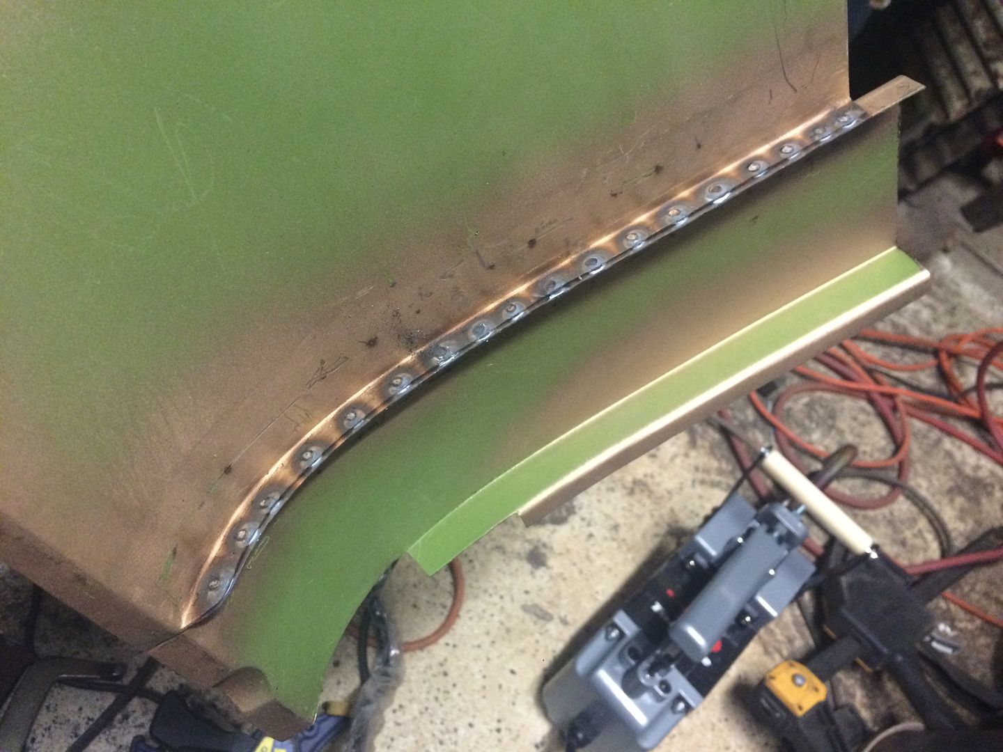

Postby Glenn A » Wed Nov 02, 2016 7:42 pm

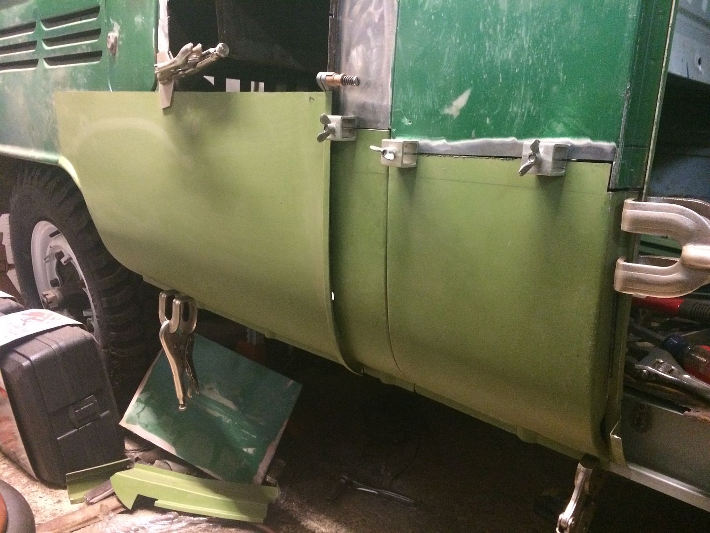

Did some more ass kicking on my DC. I'm pretty stoked at how these two panels came out.

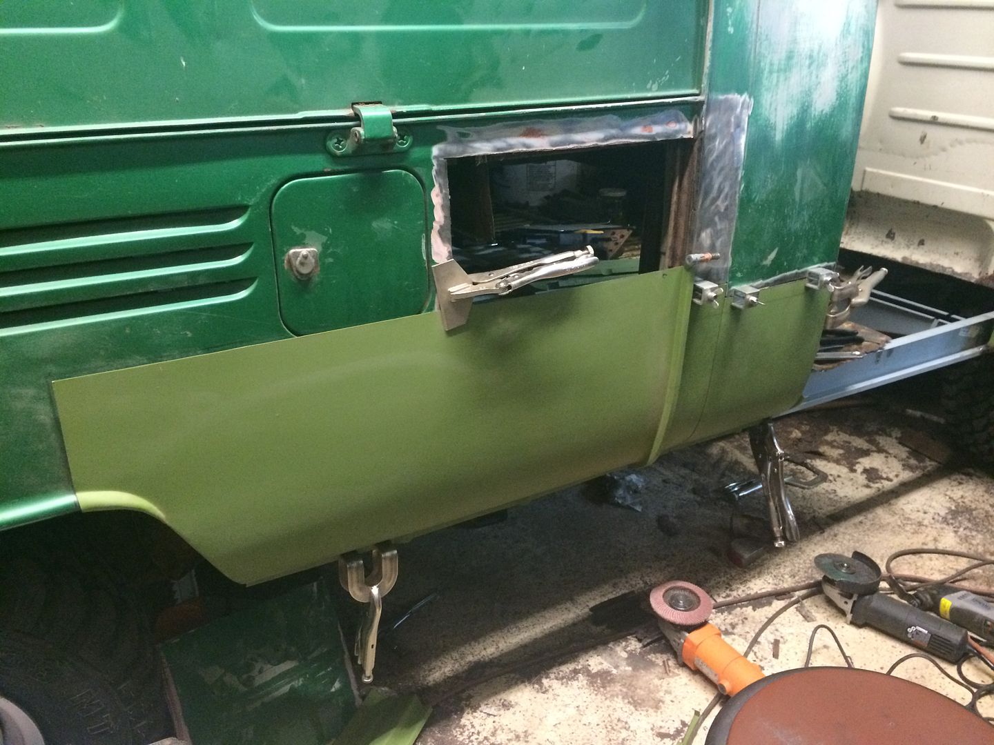

As promised. I got some work done fitting this side. I did some work to the rear middle pilar not in the pics, plus I'm trying to paint everything on the backside and use weld through paint is time consuming. I think I'm going to focus on the floor now while I still have access through this opening. Bottom of wheelwell needs some love too.
