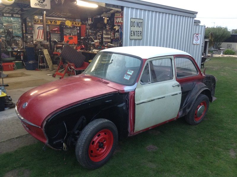

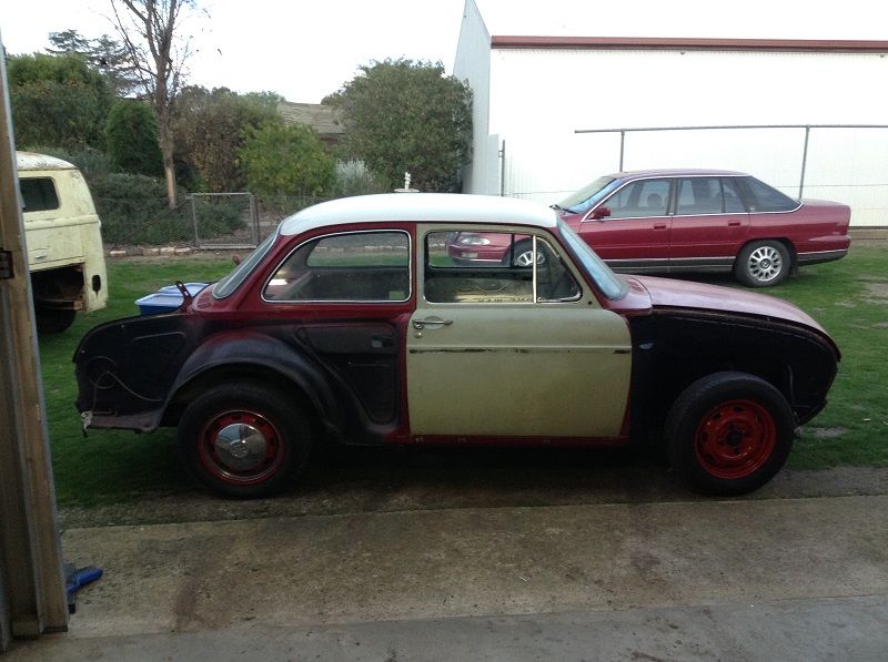

A little while ago my beetle got moved out of the shed to make way for the '67 notch.
Pretty much just been stripping it bit by bit, I will let the pics do the talking...
