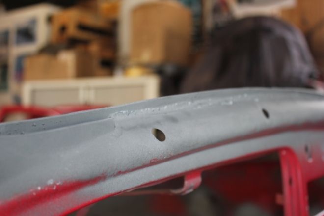

slowly getting there with the front screen, this thing had me shitting my pants at one point, WHAT HAVE I DONE!! etc.
made a completely new lip for the dashboard side, using the new panel as a template cut a 12mm strip and welded it on
welded up these holes
looks like this after much fucking about.
getting there.
stuck the hinges and bonnet back on to have a look tonight.
just need to get the last details matching up and trim the posts down to match and should be able weld it in.
cheers

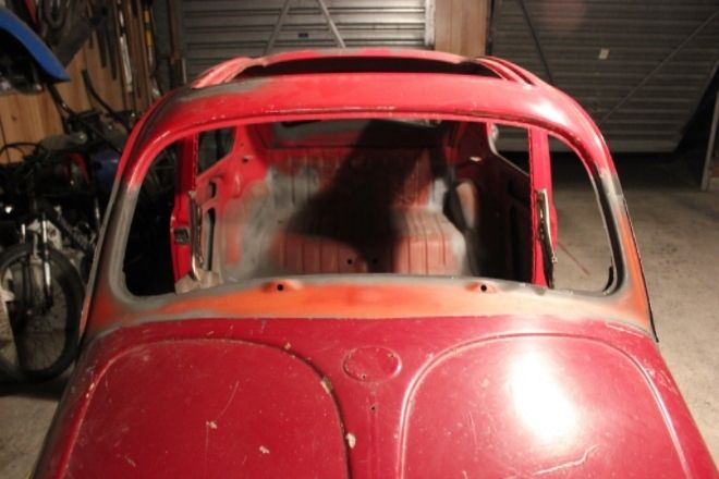

well well, what have we here.

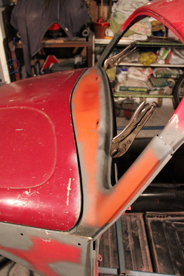

yes , some very cold looking welds, but I didn't want to blow any holes in this right now.
I had to plug weld the corners as the spot welder couldn't get in behind the corner air vents.
all stitched up.
and smoothed out.
managed to keep the joins looking factory as.
and the bonnet fits much better than the kippered old scuttle.
just need to weld up the folded over thingys and that is the rust and metal work just about fucking done!
