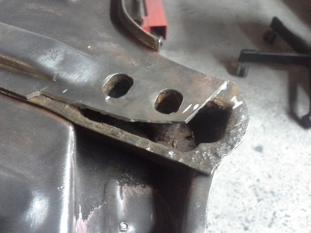

Apart from the inside of the tunnel, this pan is pretty rust free, I did find this while stripping it down.
the other side is a bit crusty, dunno if I can be assed opening the tunnel up, I wanna get this thing done and painted while the weather is warm, if I;m lucky it might be on the road before the end of summer.

sorted out the rot
other side was just starting to swell up.
trimmed the frame head.
time for a bath or shower, in acid.
