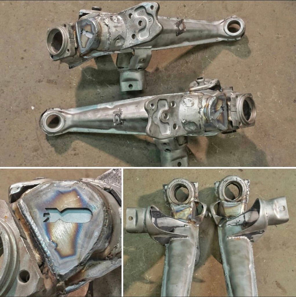

Postby Critter1 » Thu Mar 09, 2017 9:52 am
Getting closer to the IRS conversion. Trying to to have it done by KP... The good thing is, I don't have to take the car apart until everything is ready to be swapped in because its ALL getting replaced. So if I'm not ready with IRS for KP, I'll roll it as is now with swing axle. Pulled the 3.88 with .082 4th Quaife IRS trans from the bug pan yesterday. Also my 1" narrow trailing arms are on their way back to me. Done by Autowerks Suspension.
