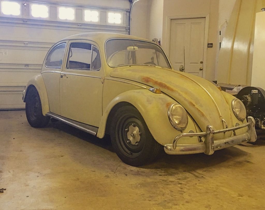

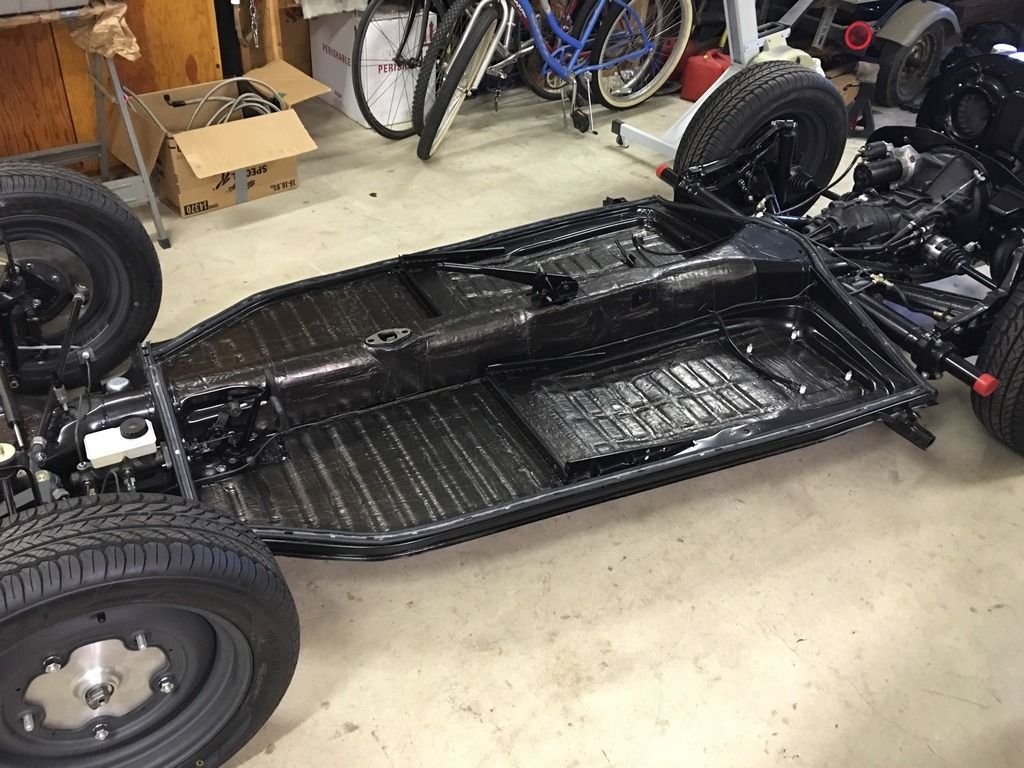

Okay. Time for a quick update. Been slacking a bit lately as allergies have been kicking my ass lately. After a day or eyes water/nose running you are about dead when you get home and you just crash. But I just put my head down this weekend to try and make as much progress as possible.
So the pan is completely finished. Went through and sound deadened the whole pan (was stoked that I found a non-asphalt based sound deadener that was the same thickness as the big dollar brands.....but in black). Didn't do 100% pan coverage, but did the whole tunnel and most of the pan halves. Didn't dick with covering the areas around the seat grams and where the pan halves butt up against the tunnel. But the pan sounds so solid now. I bought 2-36sq. ft kits of deadener.....i haven't even used half yet. Gonna have a lot left over.

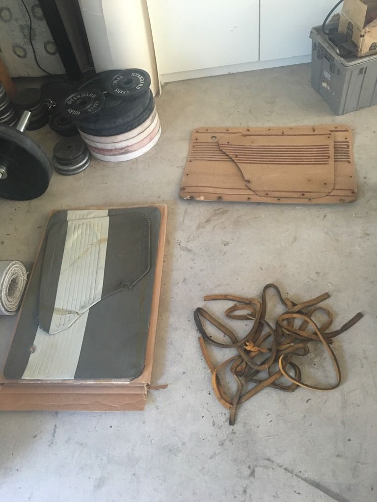

Then began working on the door panels. Due to the fact that I had fitment issues with my 65 repop panels on the last 65 and I am not going with an out of the box kit, I decided to go ahead and make the hardboard panels for the upholstery person so that I know they fit properly and will save them time. Got a set of OG panels stripped down to the hardboard. Gonna mirror the front passenger panel and the drivers rear panel. So no map pocket on the driver panel, dual arm rests and no ash tray on the passenger rear. Clean and simple. I will get finished photos once I knock out the remainder of the panels.
Last but not least, got the body back on the pan. \:D/ \:D/
I think the stance looks pretty decent the way that it is, considering that I just chose a random angle setting for the rear spring plates. It should settle some more once I get an interior in it, put the motor in, a full tank of gas, and a spare up front. But for the most part.....I am pretty happy with how it looks. That is one expensive patina'd VW. \:D/ \:D/ ](*,) ](*,)

It looks great. what color is that.
Posts: 782
Re: Bret's 65 #2 Build Thread
Postby Bret » Mon May 16, 2016 8:52 am
Glad you like it. Wink
The color is the original paint called Panama Beige. 64-65 only color. Probably my least favorite of the VW beige colors (Sea Sand in 66 and Savannah Beige in 67 both look better in my opinion), but it looks decent on this car. The beige has a little more yellow/orange than the two later beige colors.
I gotta wash and possibly buff it out in the next week or two. I have not washed the car since I got it, and the previous owner never washed it before I got it. Its pretty dirty. Hoping that a good wash and buff will bring the color out some. Its fairly oxidized. I may need to have Andy show me the ways of buffing out OG paint - he is pretty good at it.

Its called Noico. Only sold on Amazon from what I was able to find. Pretty close to the same thickness as Dynamat, FatMat and Rattle Trap (all of which I have used in the past), but for 36sq.ft. it was like $65. I actually have some Stinger Roadkill sound deadener left over from the bus build (which is a great value as well) and I actually like this Noico stuff better.
The Noico has a black square texture, but when you roll it on (for adhesion purposes to get air bubbles out) it flattens out and just looks like a shiny matte appearance. I am happy with the look. Super easy to cut.

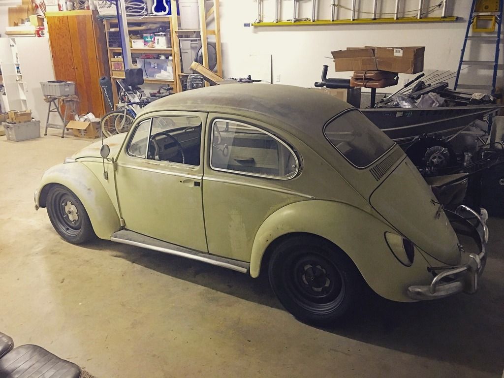

K Leake wrote:It's the same color as my 64. Thought it was the same.
This was my first VW , its my beater. Every one in the family like's to drive it.
Posts: 782
Postby Bret » Mon May 16, 2016 5:45 pm
Thats a clean looking bug! I would be stoked if my paint looked that good.
Your car has a killer stance too!
