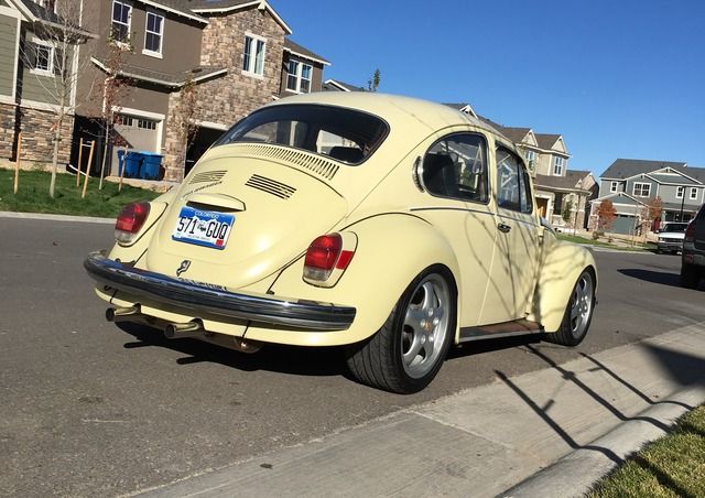

Thanks guys! It's great being back on the road full-time in a VW! I need to get some more pics of this rig to post!
KCW Internship Graduate #1
Matt Faulkner
Posts: 1366
Location: Denver, CO
Re: Matt's '71 SuperBeetle
Postby Matt Faulkner » Fri Oct 21, 2016 7:58 pm
Here's a crappy one for now. So next I'm thinking Kamei Spoiler. Anybody got one of those for sale? And I'm gonna upgrade the speakers since i cruise this one daily style! SBC represent!

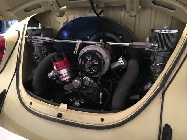

What's the engine specs?

Postby Matt Faulkner » Fri Oct 21, 2016 8:25 pm
GTV wrote:Looks good!
Engine specs...
-Old 1974 engine case
-1915cc
-Empi counterweighted crank
-Empi H-beam rods
-8:1 compression
-Web Cam 118 grind
-Century 041 heads, 40mm x 32mm valves
-Solid shaft rockers, stock 1600 ratios
-Schadek 21mm oil pump
-Empi 40HPMX carbs
-Mallory Unilite Ignition with 6A ignition box and Promaster coil
-CB Performance offset manifolds and linkage
-CB Performance electric fuel pump
-Full flow with Jaycee oil pressure bypass valve
-Vintage speed header with stock heater boxes
-Empi deep sump
-MST serpentine belt & pulleys
I think that's it...definitely the most I've ever known about any engine I've ever had.
Posts: 1886
Postby BBWB » Sat Oct 22, 2016 8:33 am
Good looking engine bay.
