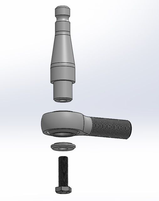

I'm honestly not sure on the control arms...they took way more time to make than I would've ever thought. Every part was turned on a manual lathe, so I've got to figure out how to make them more economically if I'm gonna sell them. I'd love to help ya out though. I'll post drawings if you've got access to a lathe, and would like to make some. Also, maybe if one of you guys has access to an NC lathe, we could run a few sets of them, and they'd be way cheaper. I'm open to ideas!

My only question is that stud for the spindle.. How's that held in place to the heim joint? Rest of the arm isn't rocket science, just that stud is my question.. Threaded/bolted on the backside with a flat washer holding it in that heim joint?

No prob Andy...I gotcha covered! 3/4" ID Heim with a 3/8-24 bolt. I machined a stepped bushing/washer to go under the ball joint.
