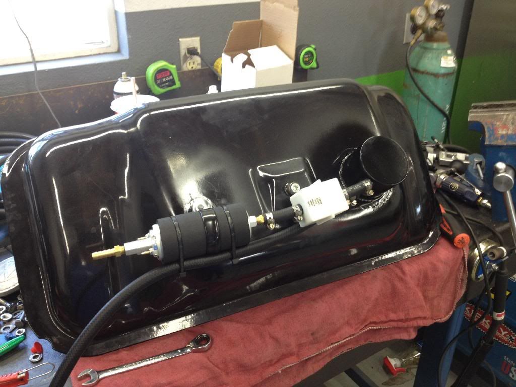

How are you doing the surge tank?
Doing a similar setup to how Jeff in Modesto does for his EFI conversions? I'm planning something similar to mine, but with a slightly deeper tank.
Posts: 3294
Re: subaru super beetle
Postby andym » Sat Sep 26, 2015 7:29 pm
Thinking about making a complete tank. I can't just add a dong'er to the gas tank because it's a super.. If I build a stainless tank then I think I can make a circle or small spot lower than rest of the tank so it will always have fuel. Supers has 168762 vent holes in the gas tank, plus the filler neck. Kinda want to use the gas flap for something else :-) Just have to pop the hood to fill it.
It doesn't have to be that deep, unless you plan on taking a nascar 1/4 mile long turn. Don't jack with it unless /until it's a problem. Try it first.
Posts: 3294
Postby andym » Sat Sep 26, 2015 7:39 pm
Hell you might be ok with just that... I'm not using a fuel filter, fuck it. Ill keep running the risk of a clogged injector..
