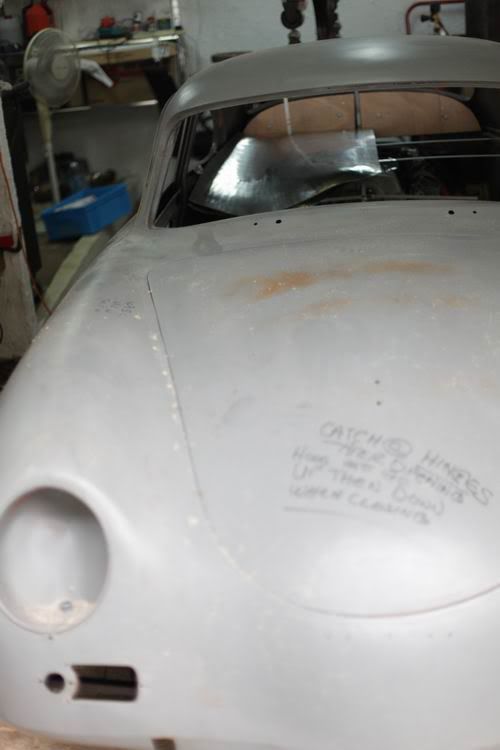

I dont have any side glass in mine, can one of you guys check the side glass on yours and tell me if its flat. If it is, its going to make the side glass a load easier in the hardtop conversion. I messed around with a cardboard template of the rear 1/4 glass and it looks like I can "just" get it down inside the rear fender.... an advantage of moving the wheels back.
So... it looks like side scoops are out.... hardtop is in!
I have a plan for the cooling.
Radiator in the front, with hot air ducted into front wheel wells... I'll cut a scoop accross the front valance to let air in at the front.....
For the engine bay.....There's a gap between the sill and the side runners in the floor. I'm going to run a scoop down there on each side and duct air up to the exhaust manifolds, and run bilge fans in the ducts so I can blow air through while its stationary. Similar deal in the centre tunnel to blow air over the front of the engine.
I'll be running an oil cooler for the engine and another for the trans also.
I've been messing around with the engine cover.... I'm going to replicate the curvy hood/fender shapes at the front of the car on the engine cover..... hopefully by the end of the weekend I should have some pics of at least the finished buck.
..... I'm going to siamese 4 exhaust tips together and make an Audi badge shaped exhaust tip... out the centre of the rear valance.

I started messing around with the engine cover today, Im going to make it similar shapes to the front of the car. Its still very much a work in progress, it needs more shaping at the front, its going to dive right down behind the seat... the cente section will emulate the hood of the 356....kinda.
I've got to work out a way to make it removable for servicing the engine.
Also, after messing around with seating positions Ive found that I can move the engine forward another 2 inches, which will help with the driveshaft angles.

That side glass isnt going to be easy.
The front window and the rear 1/4 window are not in the same plane, there's a kink at the pillar.... so there'd be a kink in the line of the glass (where the pillar is). I think this would probably look crap, so in order to go pillarless, it'd need custom curved glass and frames for the doors and the 1/4 windows......
anyone had custom curved glass done before?

Some of the high-end street rods use curved tempered glass for the wingows. I don't know much about it....but I'm sure its super $$$. Maybe you should keep it simple and just stick with the side scoop idea.

tempered curved glass is way high dollar and you have top build a template from steel in the exaxt pattern.
On the other hand if you know what your doing and it seems you do you can build you a metal template, since the car cannot be delivered to conneticut just for glass, and there is a custom glass shop that cuts side windows for chopped or custom vehicles from stock vehicle windshields. he finds a windshield for the correct curvature you are looking for and cuts the side glass from a windshield. yes i have seen him in action and yes his work is excellent.

nah... I have lexan in sides of the Tempest scratches too easily...
Cutting down side glass from something else sounds like the ticket.... for example, a CLK.... you can see from the top shot that its curved.

reread my post, you cannot cut down side glasses from something else, they are tempered and will shatter. you have to cut down stock windshields that have the correct curvature.
