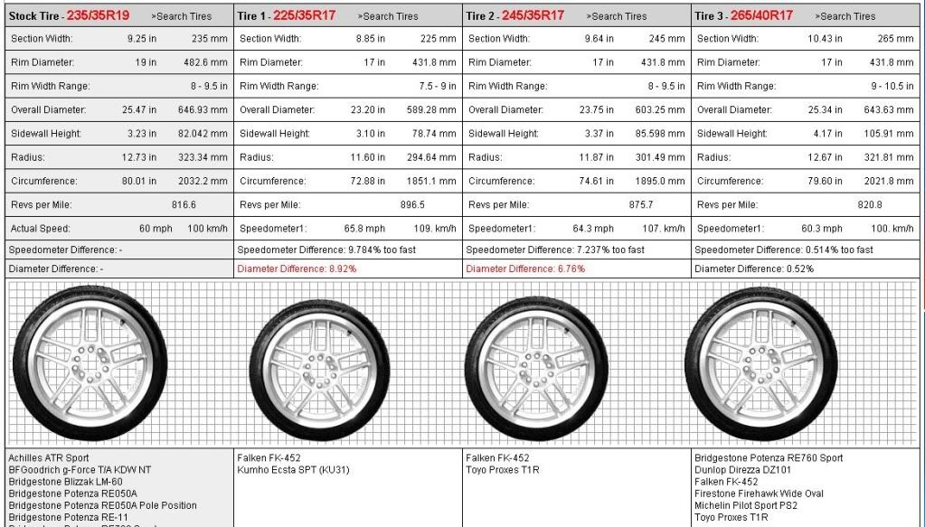

The other option is smaller wheels....If I wanna run the car at the same height as above and not change the guards, I'd have to go down to a 225/35R17......
The 235/35R19 on the left is the same size as the Work wheels in the pics at the top.... the top of the 225/35R17 tire is about level with the top of the rim of the 235/35R19.
After seeing the car with 19's under it Im pretty hooked on big rims... I think 19's and raduised guards would look better than 17's
