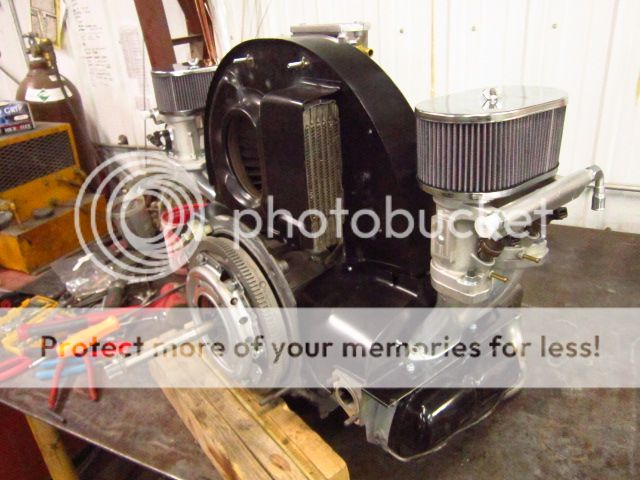

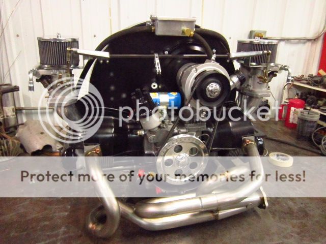

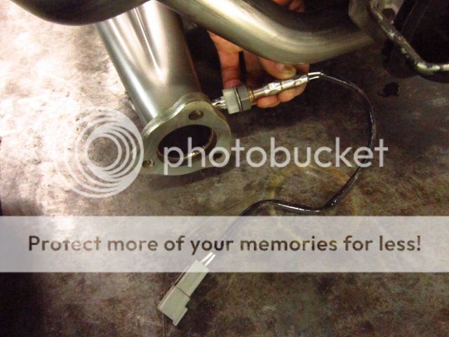

This engine is ready to plug in and make some noise! All that is left to do is weld in the O2 sensor bung....I had to order that in, should be here on Monday.

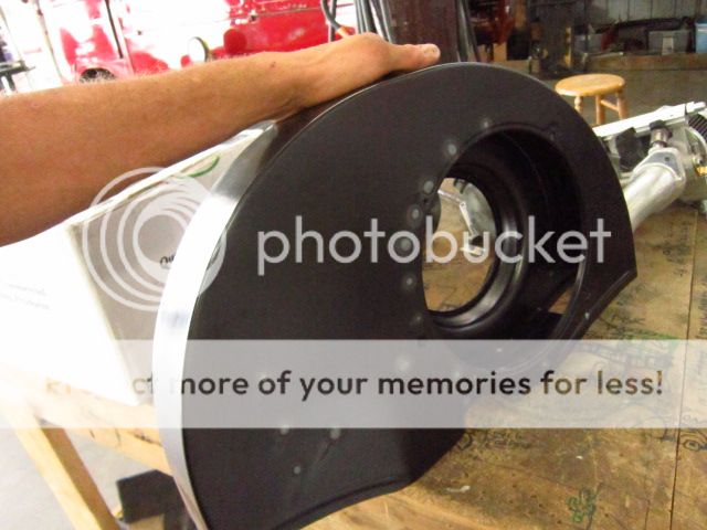

I welded the fan shroud to prevent any fins from breaking free and rattling.

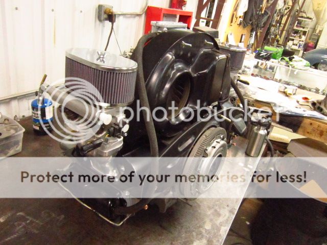

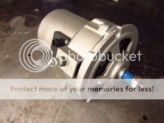

Upgraded the clapped-out used alternator to a brand new high-output 90amp version.
Clutch, late model type 1 to fit the baywindow throw-out bearing.

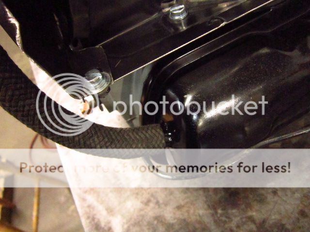

Breather box system with fittings welded to the valve covers.

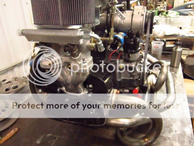

Stainless sidewinder.

I'd be interested if that alternator really puts out 90 amps and if so, at what RPM..... :-k

Jesus, Greg.. why do you hate freedom??? It SAYS it on the box... Smile Smile

Tuned Perfection
Postby Tuned Perfection » Mon Jul 23, 2012 11:25 am
Yeah, I know, here we go again.
When I was having my alternators repaired locally the guy told me there was no way I would ever be able to spin the alternator fast enough to make the amps I wanted at the time (I think 75). He asked if I could get a smaller pulley to spin it faster and I said no, only a smaller crank pulley to spin it slower.
Hence my interest in the (no doubt since it is from Empi who is known for the overwhelming quality in their parts) 90 amp alternator. Smile
