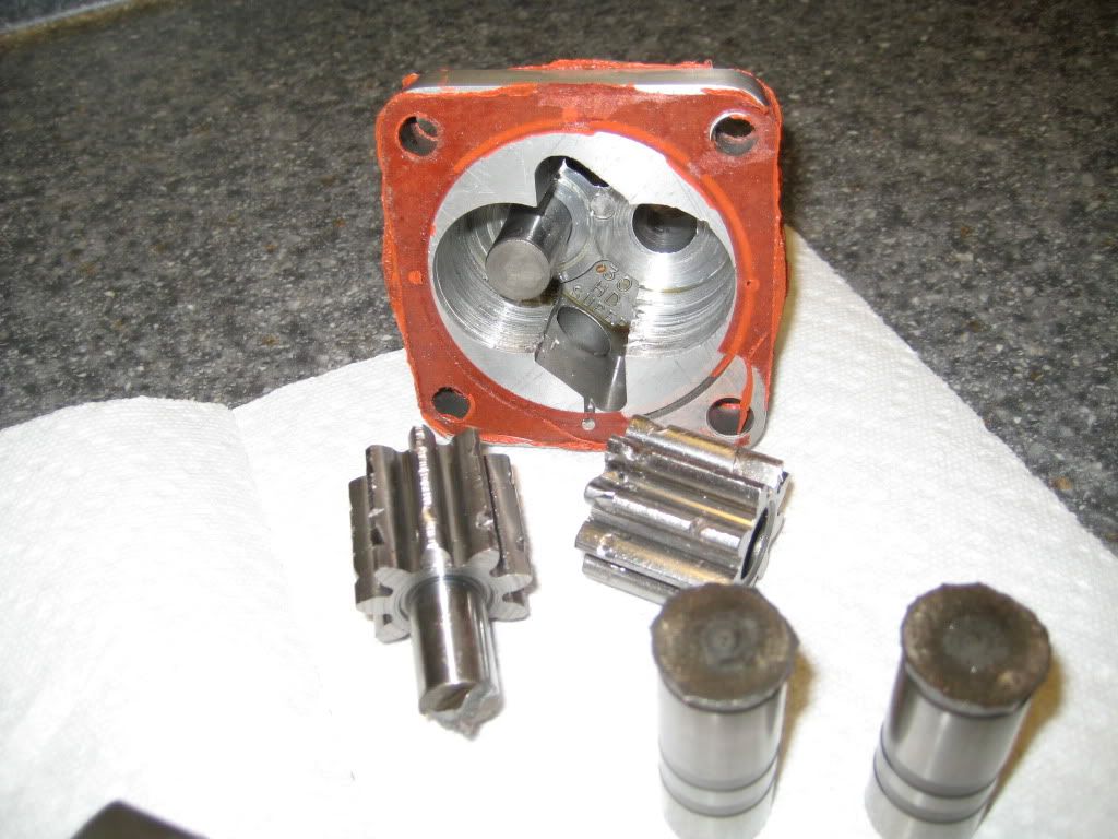

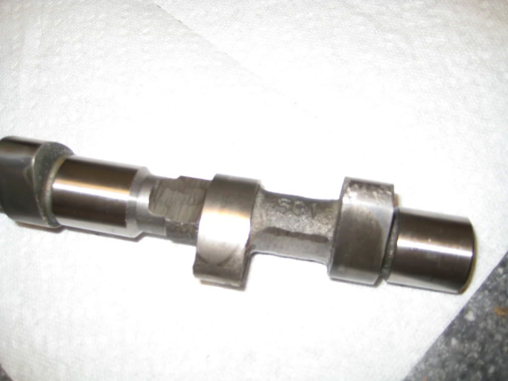

vdub wrote:
VGMutah wrote:Also on the subject of oils-gear oil in a VW trans should be rated GL-4. It's hard to find now days, unless you buy a synthetic like Amsoil. The price of filling your trans went from $6 up to $25-30 just like that. The VW syncros don't operate properly with other gear oils like the easy to find and much less costly GL-5 ect. Bummer...
GL-5 is completely backwards compatible.
I have been running it for years with no problem.
Wow, It looks like you had to much lift or the lifters where to fat for the lifter bore.
Maybe even ran dry and froze the oil pump.
